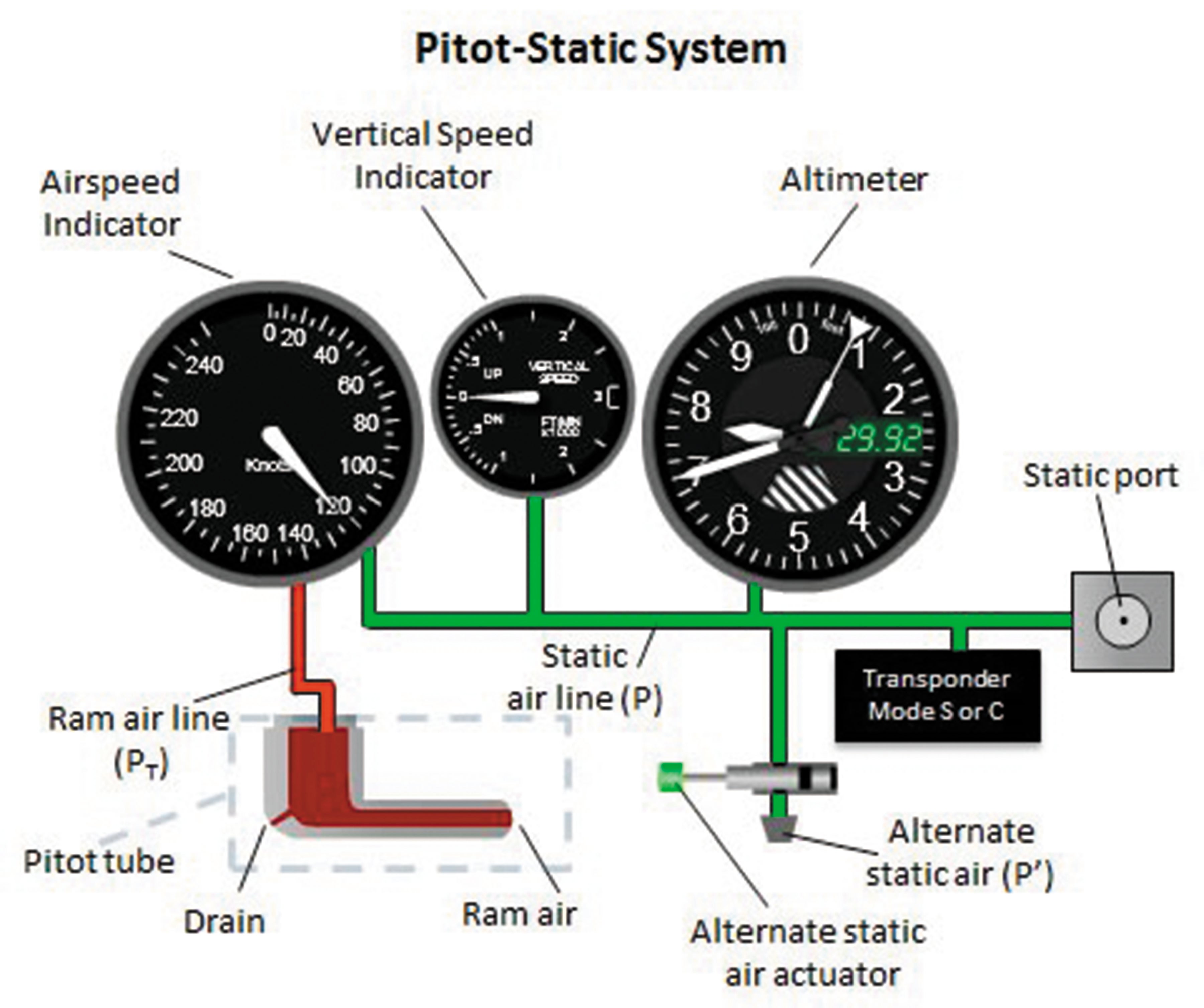

Being able to diagram the pitot-static system helps relationship and functional awareness recall.

From our earliest days as student pilots, the instructor probably explained how pitot-static instruments work as well as the “plumbing.” During my private checkride the examiner asked me to diagram the system and explain its operation.
A Quick Review
The pitot tube is only connected to the airspeed indicator, allowing ram air from the slipstream to create dynamic pressure. Some pitot tubes have a drain for water at the rear where the tube bends. The airspeed indicator (ASI) measures the difference in pressure (delta-P) between the dynamic and static pressures and presents that difference in knots (or MPH in older airplanes).
The static line is connected to all three instruments: airspeed, vertical speed indicator (VSI) and altimeter. Since the static line is vented to the outside of the airplane, it provides atmospheric air pressure to the instruments. Some airplanes have one static source or port, others have two. With two ports, they are mounted typically on different sides of the fuselage to minimize static pressure differences when the airplane is slipping or skidding.
Additionally, in the off chance that the static ports are blocked, an alternate static source valve provides static pressure taken from inside the cabin—assuming an unpressurized airplane. If pressurized, the alternate static source is in an unpressurized part of the fuselage. The alternate static source should not be confused with an alternate air source for the engine.
During level flight at constant airspeed, no air moves in or out of the pitot tube or static line. Only with a change of airspeed or altitude will air move into or out of them due to the change in pressure.
