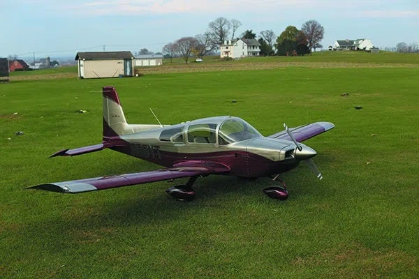

The estimate—$17,000—was based on what I really wanted: an adaptation of my Cheetah N9690U’s style, which is a split scheme with silver over red. Weaver said he would have to shoot in a basecoat/clearcoat because the silver and red metallic finish would oxidize too quickly. Finally, someone was willing to do what I wanted, when other shops wouldn’t even quote me a clearcoat finish.
With a working budget of $15,000 to $24,000, the approximate $17,000 quote was something I could surely live with in hopes of getting my dream finish. The automotive work in progress at his shop was impeccable, and instilled confidence. The estimate to completion was six weeks, but I planned on seven.
Counterclockwise from upper right: It’s small details that separate mediocre paint jobs from excellent ones, including the subtle accents around the registration numbers. That’s the Grumman in a coat of epoxy primer. Run your hand over the clearcoat-covered stripes on the wheelpant and you won’t find sharp edges. That’ll hold up better over time. Finally, a tech at Circle W is custom airbrushing the Grumman’s tail.

Finally, six weeks into the project, we were ready for color. The order of painting in basecoat/topcoat is non-traditional as well. The lighter colors are sprayed first, then masked and darker colors are sprayed over. For example, the wheel pants are red with a silver/gray stripe. You would expect it to be painted red then add the stripes. Not so—the wheel pant was painted completely in silver first. The stripe is masked off and then painted in gray, masked off again and then red is the final coat. I asked why and was told that the silver won’t look right trying to cover the red. The results speak for themselves.
As time went on, I because more impressed with the shop’s abilities and artistic acumen. Toward the end, rather than directing the scheme, I let Weaver tell me what he thought would look good. I had planned on simple block-style N numbers, but he suggested a thin perimeter stripe with an airbrushed shadow (for a simple $100 up-charge). The result is beautiful.

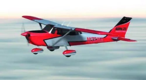

Our go-to paint specialist, Craig Barnett at Scheme Designers (who specifically noted the Sherwin Williams SKYscapes product), told us that a basecoat/clearcoat affords an opportunity to use less paint because there is better coverage. Better yet, if the final clearcoat layer covers the entire aircraft, it reduces the so-called tape-edge appearance /feel of stripes. A SKYscapes basecoat/clearcoat also has a short drying time between color applications, which reduces the time the aircraft is in the paint shop. The shop can apply multiple colors in one day, instead of it taking multiple days per color application.
Barnett recalled the premium and complex four-color paint scheme done on an AOPA sweepstakes Cessna. “We applied that entire scheme—from masking to final color—in just two days. The process might generally take over a week using precut vinyl paint masks.”
Julie Voisin at the Sherwin Williams Aerospace Coatings division reiterated the fact that a clearcoat simply reduces upkeep. “Without a sharp edge on a stripe, for example, there are less chances of adhesion issues since the entire paint job is wrapped in the clearcoat,” she told us. Voisin also pointed out that repairing damage to the clearcoat is a heck of a lot easier than repairing the paint surface. “In many cases you won’t have to get a custom color mixed for the damaged area. That protecting clearcoat surface is a sizable advantage when it comes to upkeep,” she said. There’s also better UV protection. Since weight is a concern, the typical clearcoat thickness is roughly 35 to 50 microns.
