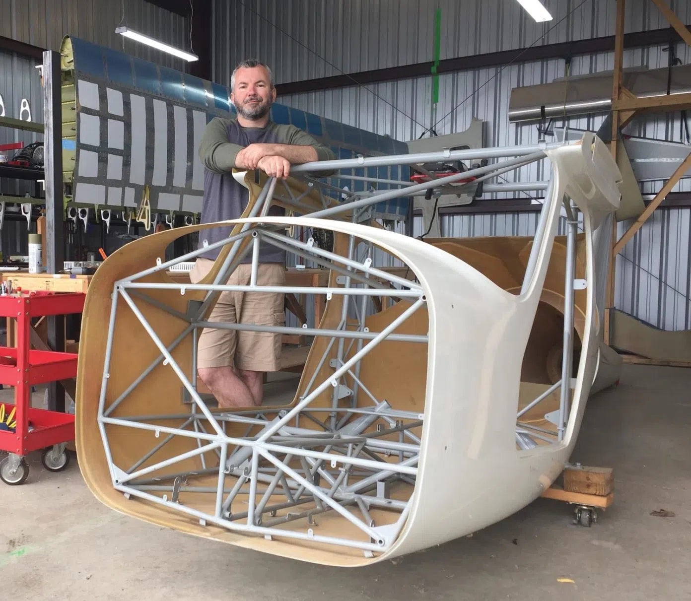

My project was in the attached two-car garage, only a few steps away, but that didn’t help. Then I moved halfway across the country and the project was stored in a T-hangar about 30 minutes away which made accessibility even worse—it sat with only an occasional visit to make sure it was still there.
Fast forward a few years. The move is history, house remodeling completed, and work finally organized to leave me some spare time. I’ve gotten back to the GlaStar project.
But restarting isn’t as simple as flipping on the light switch and getting back to work. The first step was to organize the shop. Again.
When the project was at the old house, I could get by with one set of tools, but with it now residing in a hangar 30 minutes away, I had to buy a second set of tools—those that are not specific to airplane building. I had a lot of tools before, but now I have nearly twice as many!

The partly-built left wing is in the jig and the spars for the right wing are in the other one, leveled and aligned, and it’s back to work. I was a bit apprehensive about this moment, not knowing how much I’d have to re-learn, but I was pleasantly surprised how relatively easy it was to pick up where I left off years ago. That doesn’t mean I hadn’t forgotten anything. The old saying about riding a bicycle seems to hold true—tasks that involve dexterity felt completely natural. Muscle memory for the win!
So far, I’ve had to look up reference data for fasteners—information that seems to have been purged by my brain, but there will certainly be other things I once knew for which I now need a refresher course. Learning new things is part of the fun, so I really don’t mind remedial education in this case.
It’s normal to expect some damage when moving a project this big, but I was very careful, and the only damage was to a flap cove rib—an easy fix. This kind of “hangar rash” damage can be expected even if the project is just sitting around for a few years. I’ve seen other idle projects with piles of stuff on top of airplane parts, and that kind of treatment is surely going to lead to various squawks once the builder gets back to work. A bit of advice for anyone with a project on hold: keep it clean and dust-free. The GlaStar has a steel-tube cage in the fuselage, and I’ve found some surface corrosion on a couple of tubes where dust had collected and remained undisturbed over the years. Fortunately, that too is an easy fix, but it was entirely avoidable with a wipe of a rag.
