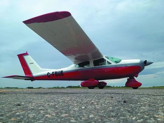

That’s an early model Cessna Cardinal with Maple Leaf Aviation’s landing gear, cowling and exhaust fairing speed mods. Cruise speed is advertised to increase as much as 12 MPH.

Maple Leaf Aviation
Focused on making fixed-gear, piston Cessnas go faster, Maple Leaf Aviation (www.aircraftspeedmods.ca) emphasizes the Cessna Cardinal line. While we have not had the opportunity to fly the Maple Leaf mods, we consulted with Paul Millner, previously the head of Cardinal Flyers Online and an occasional contributor to this publication. He advised us that members of Cardinal Flyers spoke well of the effectiveness of the speed mods for the Cardinal.
Chief among the Cardinal mods is a cowling cover for the 1968 177 and 1979 177A models. The forward cowling is a high drag area for those airplanes—Maple Leaf’s cowling cover more closely matches the design of the 177B model (beginning in 1970), improving airflow, rate of climb and cruise. Millner told us that CFO members who had bought and installed the $450 kit said that they are much more confident about using short strips because of the increased climb performance. Cruise speed is advertised to increase from 8 to 12 MPH.
The nosegear strut is also a high drag area for the Cessna 172, 177 and 182 series machines. Maple Leaf offers “Fancy Pants,” a fairing that fits between the top of late-model wheel pants and the bottom of the cowling. Priced at $779, a speed gain of 3-5 MPH is advertised for the 172; for the 177 and 182, it is 6-8 MPH.
Maple Leaf also determined that the main gear leg fairings on the 177 series could be improved and designed a set that is lower drag and also fairs in the brakes. They are advertised to increase speed by 3-4 MPH and are priced at $1116.
