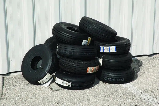

Tires are replaced most often for deterioration caused by sunlight, weather extremes or ozone-related cracking. Any time fabric or casing is exposed, the tire is not airworthy. And a tire can look perfectly fine yet be well past its sell-by date. For example, we’re aware of a tire/tube combination in long-time, regular service on a hangared airplane without any visible problems except minute cracking. Then it started losing air and was retired. Records reflect it was on the airplane for some 15 years.
Meanwhile, the discussion of what type or brand of tire is best will never end. Some operators subscribe to the theory of replacing tires more frequently with cheap ones since it seems that ozone cracking is a function of the calendar rather than hours or landings. While this can be argued, in my experience tires in the medium-to-high price range seem to resist ozone cracking and weathering longer than a cheap tire, making the more expensive tire a better value. In addition to resistance to ozone cracking, the more expensive tire has proven to last longer both in landings and resistance to weather/ozone and provides a greater safety margin for most aircraft operations.
Cheap tires are like most anything else in life—you get what you pay for. While all aircraft tires must pass the same TSO specification, cheap tires may pass the test when new but can fail testing criteria after just a few months of use. If your valuable aircraft has higher landing speeds, higher operating weights or is used in adverse conditions such as rough or short runways, higher density altitudes or high outside air temperatures, the high-end tires usually are the best value for your money.
