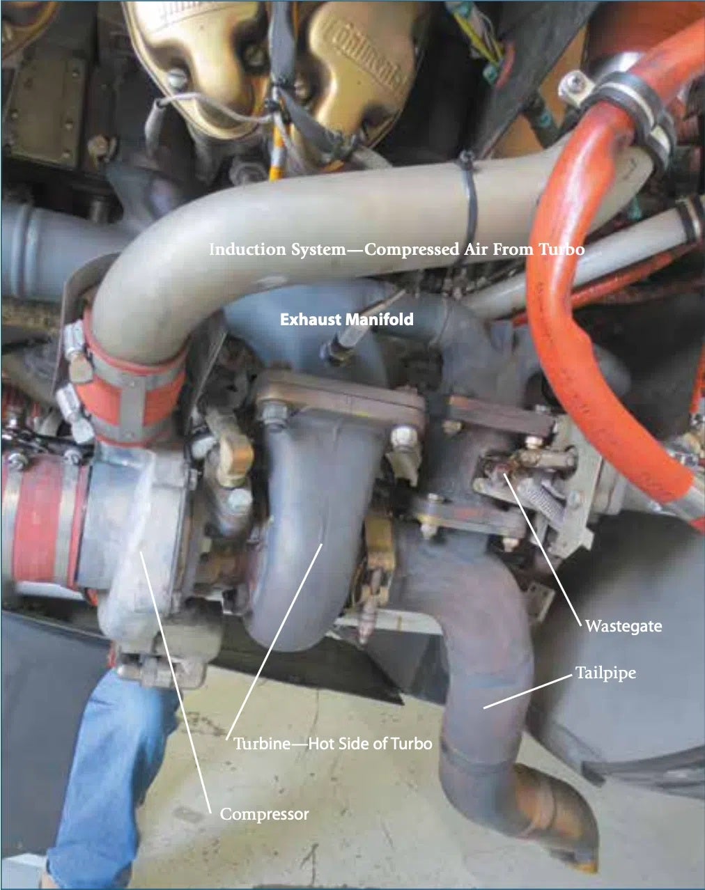

A turbocharger is an air pump that sends compressed air to the engine intake system. Half of it is a turbine that lives in the hellish environment of the exhaust system—its wheel is spun by those fiery gases. When fully engaged it can spin at over 100,000 RPM and glows brightly enough for a person to read a book.
The turbine wheel shaft extends through the center housing into the cold side, where it spins the pump that compresses the ambient intake air and jams it into the induction system, allowing more power to be developed.

A wastegate—the butterfly valve in the exhaust pipe upstream of the turbo—routes air either down the remainder of the tailpipe or diverts it into the turbo, or some mixture of the two. When closed, it all goes into the turbo.
Some wastegates are fixed—the pilot controls power with the throttle—and some are manual—there is a second control in addition to the throttle that the pilot must use in setting power. However, most are automatic—a controller senses the pressure of the air in the upper deck of the induction system, just upstream of the throttle body, and uses engine oil pressure to set the position of the valve in the waste-gate to maintain the manifold pressure the pilot has commanded with the throttle. Properly adjusted, an automatic system requires no action by the pilot during a climb or descent—which is not the case with a fixed or a manual wastegate.

The induction system has been disconnected from the compressor side of this turbo for visual inspection. The oil supply routes into the center between the compressor and turbine. On this installation, a heat shield surrounds the turbine.

To get an idea of the harsh environment and tight quarters in which many turbochargers live, this is looking straight down on the turbo and tailpipe on the right side of the front engine of a Cessna P337 Pressurized Skymaster. The airplane is used in a Part 135 operation and the company president reports that he’s never had to overhaul a turbo prior to engine overhaul.
