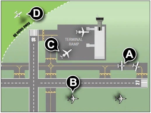

Tower and radar controllers must clearly define the last departure (A) and arrival (B) on the old runway, and the first departure (C) and arrival (D) on the new runway.

I’m working Ground, Clearance Delivery, and CIC combined at your destination airport. We’ve been on Runway 27 but the winds have swung south and airplanes on final are crabbing pretty hard. I’ve got two aircraft already taxiing to Runway 27 for departure and an airliner just starting push off his gate.
I examine Tower’s radar display. No one’s on final, but Approach has a couple arrivals on a left downwind for 27. The last one is doing 180 knots and has about 15 flying miles to the runway.
Much of what we do is based on time. For sequencing and speed control, we use miles per minute, not miles per hour: 180 knots ÷ 60 minutes = 3 miles per minute (mpm); 15 flying miles ÷ 3 mpm = 5 minutes before that second aircraft lands on Runway 27. It’ll probably be a bit more since aircraft slow on final, so call it seven minutes.
The next closest arrival is, well, you. You’re forty miles out, about to enter Approach’s airspace. Radar shows you at 150 knots, or 2.5 mpm. So, you’re (40 miles ÷ 2.5 mpm) 16 minutes away. That gives us a nine-minute window during which we can easily switch the active runway. So, let’s get cracking.

I turn to my friend on Tower. “Looks like those winds are staying out of the south.” I point to the two aircraft already taxiing. “Are you good with changing over to Runway 18 after these two go, and the two on the downwind land?” I ask in case there’s some detail I’m missing that would preclude changing runways right now. That’s part of our crew resource management.
“Yeah, I was watching that too,” he says. “Let’s do it.” Cool. We’ve got a unanimous decision in the tower. However, we are not alone in this. I need to follow our checklist and coordinate, beginning with notifying our approach control.
I key up a recorded landline to Approach’s supervisor. “We’re looking to go Runway 18. I’ve got two departures taxiing to Runway 27. What do you guys have?” Again, for CRM, I’m looking for a reason not to go to Runway 18.
He puts me on hold to check with his radar controllers. A minute later, he’s back: “Okay, we’re good. Last arrival to Runway 27 will be N123AB, the second guy on the downwind. First arrival to Runway 18 will be [He gives me your callsign]. Who’s your last Runway 27 departure and first one off 18?” I give him the callsign of the second aircraft taxiing out to 27, and inform him my initial departure off 18 is the airliner pushing back. Now we have a defined start and stop point for each runway.
“Okay,” the supervisor says, “call for release off Runway 18.” Normally our airport has automatic departure releases, i.e. we can just launch aircraft as long as they’re on agreed-upon headings and altitudes, and approach is notified they’re coming via a landline call or their callsign flashing on their radar scope. However, a runway change is a sensitive time. Therefore, “automatics” go away. Before departing someone off Runway 18, Tower must call for a verbal release.
The supervisor then calls our overlying center. Center’s staff reconfigures their computer automation so our departures off the new runway will automatically hand off to the appropriate radar sector. They’ll also notify the center controllers themselves, who have their own procedures to follow.

Meanwhile, our last two departures have just taken off from Runway 27, and the last arrival to 27 is rolling out. The airliner is holding short of Runway 18, but Tower can’t just launch him immediately. We’re still under a “call for release” order. Tower calls Approach. “Request automatic releases off Runway 18.” His request is approved, and he clears the airliner for takeoff.
A few minutes later, you check in on Tower’s freq. They say, “Cleared to land Runway 18.” Every element of the runway change is now complete!
