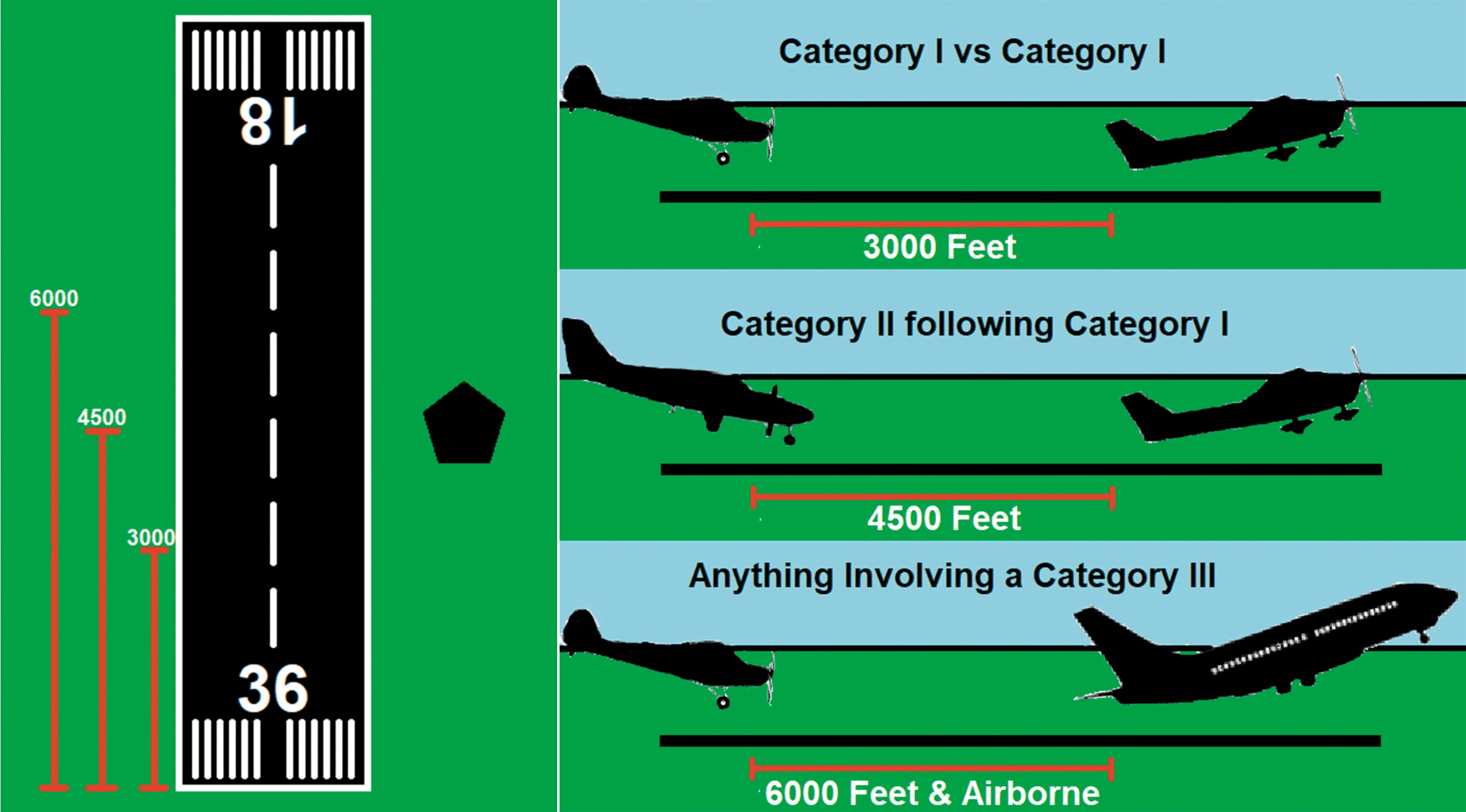

So, maybe now you’re asking, “what runway separation does a Tower controller give?” I’ve illustrated that for you, but it’s actually pretty simple: 3000 feet between two Category 1 airplanes or a Category 1 following a Category 2; 4500 feet with two Category 2 airplanes, and 6000 for anything over 12,500 pounds.
Runway separation minimum varies with the type of aircraft.
Category 1 is a single engine piston under 12,500 pounds. Category 2 would be twin-engine aircraft under 12,500 pounds, and Category 3 is everything else. If you fly a piston single, I really hope this one hits home. I see a lot of small aircraft that are hesitant to cross the landing threshold because the other airplane is either not off the runway or not on the go yet. It’s mainly a trend with student pilots, and might stem from good non-towered field etiquette.
If I have a 10,000-foot runway, I could technically have 3 airplanes on the runway at once, as long as each is a Category 1 and they’re all at least 3000 feet apart when they pass the threshold. The threshold is the big white line marking the start of the runway and some of us call it “the fence.”
Unless it’s a formation flight, runway separation is based on two airplanes. At most Class D airports, controllers use this to keep efficiency at its highest, suitable landmarks are a clear requirement so we can accurately judge that distance. There is some discussion on what can be used for that, but the main thing we look at are the runway distance remaining signs.
