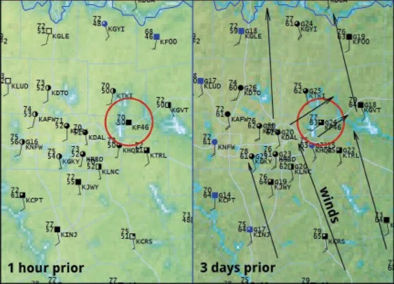

This weather chart shows the erroneous winds being reported at Rockwall (KF46).
  • Even with advanced weather infrastructure, equipment failures can provide erroneous data, necessitating pilot vigilance, cross-verification with other sources (e.g., wind sock, CTAF), and adherence to safe flying practices.

During the NTSB accident investigation, technicians checked all the weather equipment. Large directional errors were found on the wind sensors. The technician estimated an error of up to 40 degrees, while a review of weather data from three days earlier indicated a 60-degree error. The reason? A 10-cent screw was missing from the wind sensor azimuth mount, allowing it to be pushed out of alignment, most likely by a large bird attempting to land on the sensor. Previous METAR observations showed that the wind equipment had been misaligned for at least 25 days.
A review of surrounding area winds showed winds out of 170 at 10 knots throughout the Dallas area, clear evidence that the Cessna 182 was landing with a 10-knot tailwind. An improper landing setup was certainly the cause, but the NTSB cited the wind equipment failure as a contributing factor to the accident. This led to the wrong runway selection and gave the pilot the impression that there would be a slight headwind on the approach.
