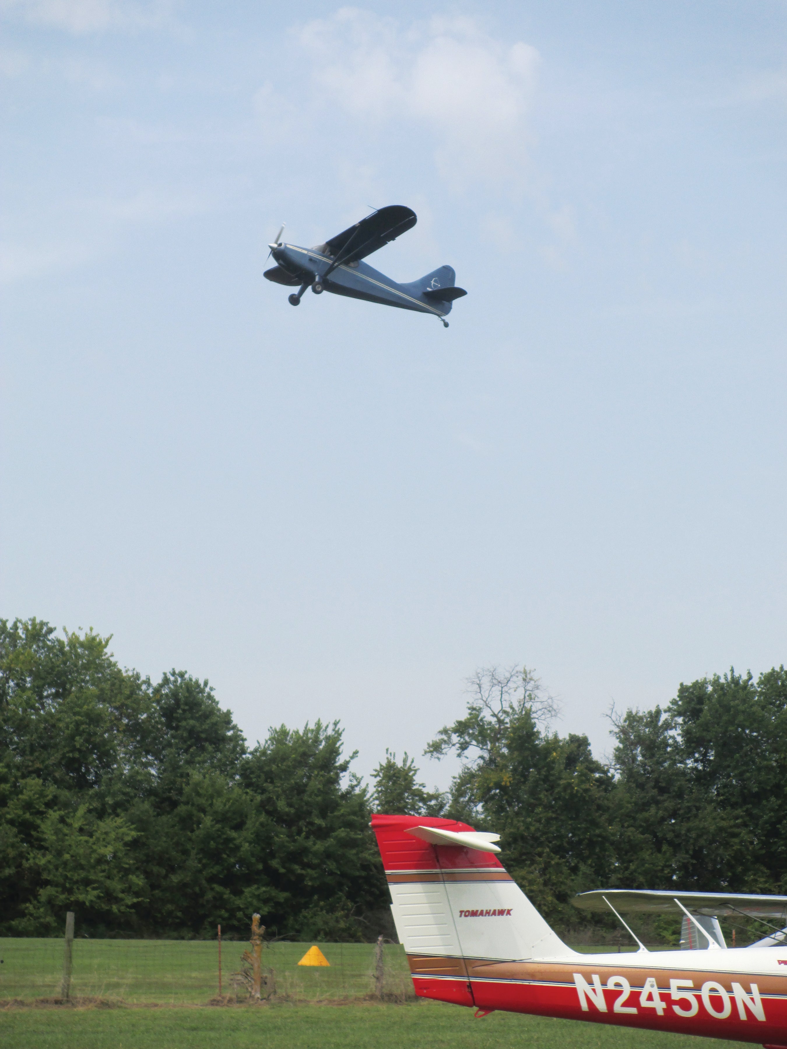

We execute a go-around to avoid a landing situation that carries a probability of harm to ourselves or the aircraft. Image: LeRoy Cook
We execute a go-around to avoid a landing situation that carries a probability of harm to ourselves or the aircraft. Each approach to a landing should be viewed as having an optional outcome. If the airplane is under control, stabilized, and likely to land in the first few hundred feet of a welcoming runway, we’ll carry through with the touchdown. If not, we’ll transition from our final approach configuration into a climbing condition, just as we planned.
