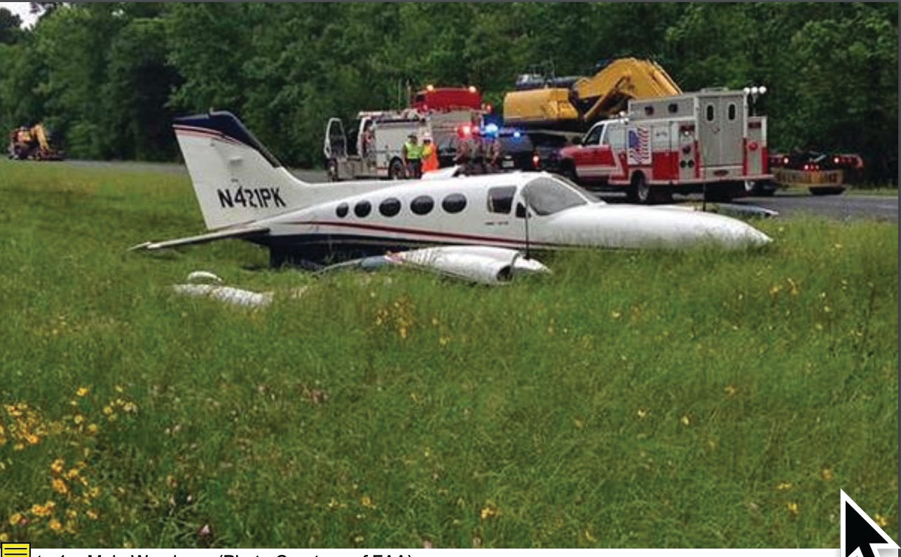

Misfueling accidents aren't as frequent as they once were, but that's what took down this twin Cessna.

Fuel plumbing, like the Cessna 310, is a source of confusion for pilots.
