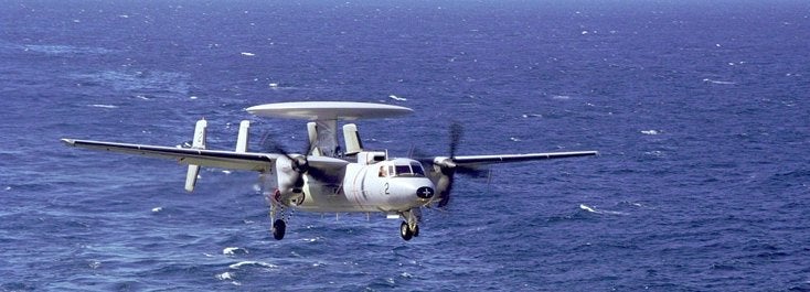

It could be argued that just about every trap on a carrier is a close call but video released this week by the Navy shows just how close it can get. An E-2C Hawkeye was landing on the deck of the USS Dwight D. Eisenhower March 18 and while a gust lifted a wing just before touchdown, it appeared to be a normal landing. But the arresting cable broke and that’s when things got interesting. The cable didn’t break until the aircraft was most of the way down the deck and well below flying speed. The accompanying video below shows the plane disappearing off the prow of the big ship before struggling back into the air. Eight sailors were injured by the writhing cable.
