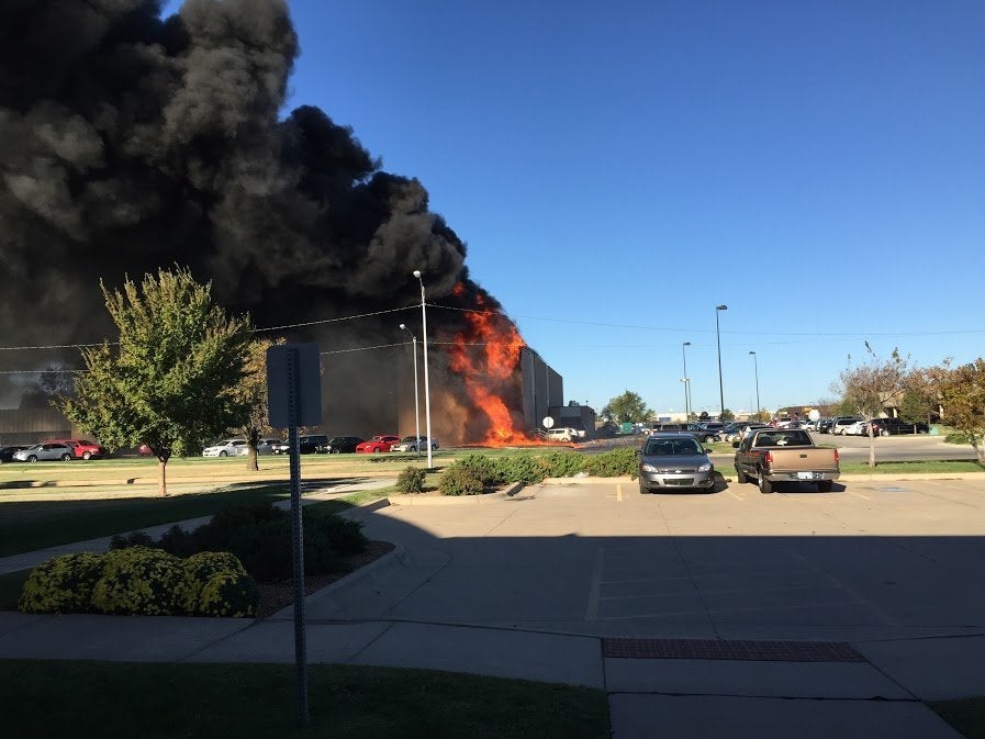

The pilot of the Beechcraft B200 King Air that crashed into a building at Wichita’s Mid-Continent Airport in 2014 failed to follow emergency procedures including correct use of rudder, leading to loss of control, the NTSB said in its probable cause report released this month. The pilot, a retired air traffic controller, was killed along with three people in the FlightSafety International building, while six others were injured. During initial climbout, the pilot declared an emergency and said the King Air “lost the left engine.” About 120 feet above the ground, witnesses saw the aircraft, with its gear down, turn left and crash into the building. A fire then consumed most of the aircraft.
