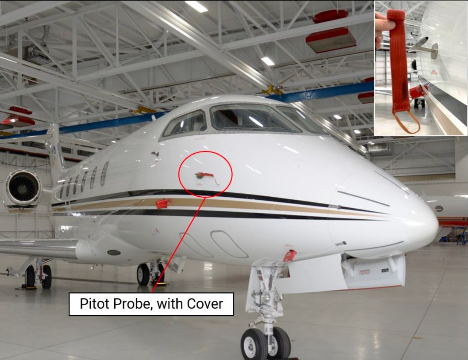

The Challenger was chartered to fly three passengers from Keene, New Hampshire, to Leesburg, Virginia, on March 3, 2023. The same plane had brought them to Keene the day before. During preparation for the flight, the second-in-command pilot was interrupted on his walkaround and forgot a pitot cover. That resulted in an aborted takeoff when airspeed readings disagreed. The crew did not consult their emergency checklist, which said the disagreement and aborted takeoff was a “No-Go” situation requiring a call to maintenance. Instead, they stopped on a taxiway, the SIC retrieved the pitot cover and they prepared to take off again. The panel showed a Rudder Limiter Fault advisory but rather than consult the corresponding checklist, which identified it as a No-Go item, the crew elected to troubleshoot it themselves after takeoff.
