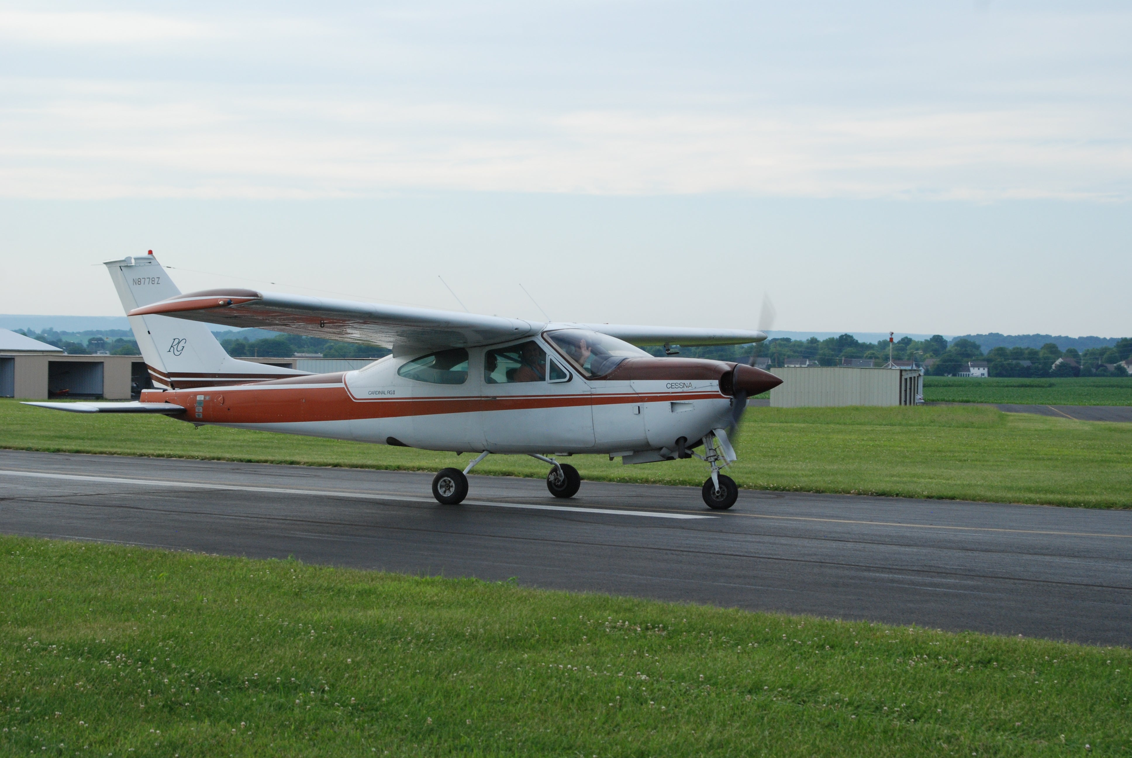

  • A 1978 Cessna 177RG (N8778Z) was recently restored by Marc Martin, his father, and brother.

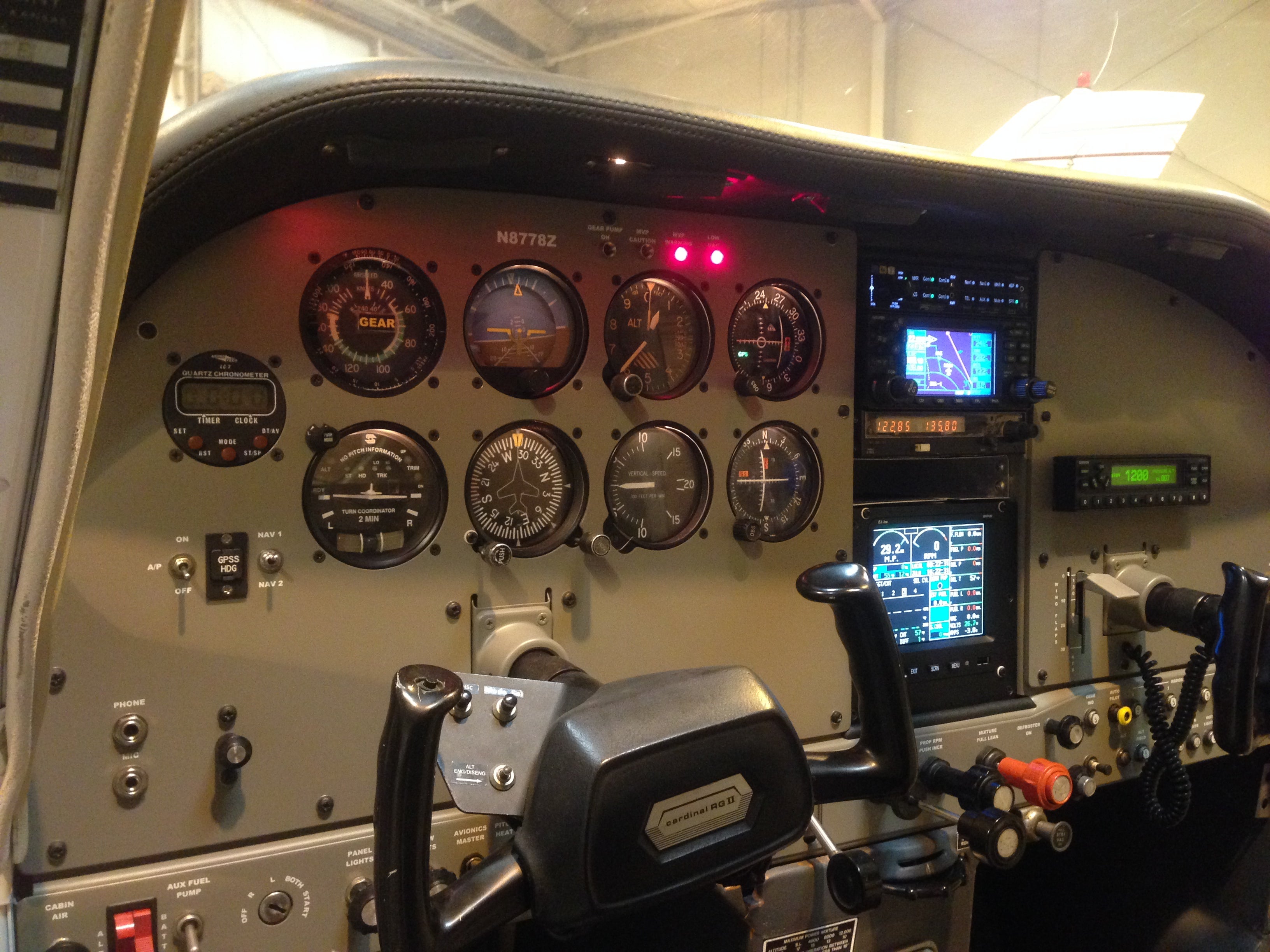

  • The restoration included a full repaint and a significant panel upgrade with modern avionics, such as a Garmin GNS430W, STEC-30 autopilot, and EI MVP-50 engine monitor.

Forty six years later, that’s still true, as proven by this nice restoration project submitted by Marc Martin who, along with his father and brother, restored a 1978 Cessna 177RG. Here’s a summary of the project:
“My father, brother, and myself own N8778Z, a 1978 177RG. Since purchasing it a few years ago with original paint, we have had the paint redone, and weve just completed a panel project, installing new panels and replacing all engine gauges with an EI MVP-50 engine monitor. With a Garmin GNS430W, STEC-30 AP with altitude hold, GPS roll steering, full engine monitoring, and current paint, we feel we have a quality airplane with close to new capabilities, at less than a quarter of the cost of new.”
