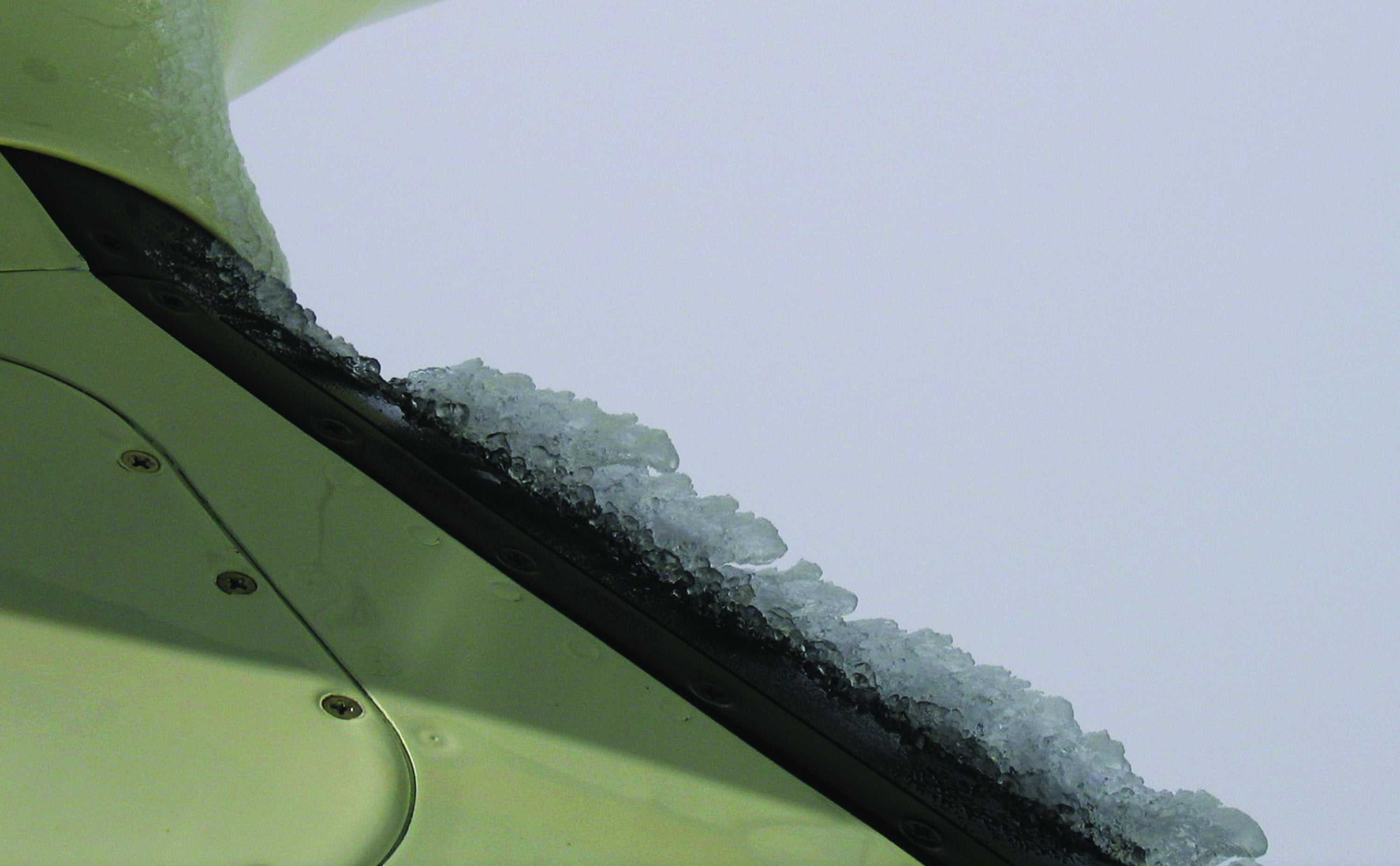

The greatest hazard of airframe ice is the adverse and unpredictable effect ice has on aerodynamic surfaces. The wings and tail will be less effective with even small amounts of ice; further, since ice accumulation is not always symmetrical, there’s a strong likelihood the adverse effects will come unexpectedly, without warning. If airflow disruption is the biggest hazard, it seems reasonable that simply keeping your speed up will overcome the adverse effects and assure a safe landing with a load of ice. This rationalization is flawed.

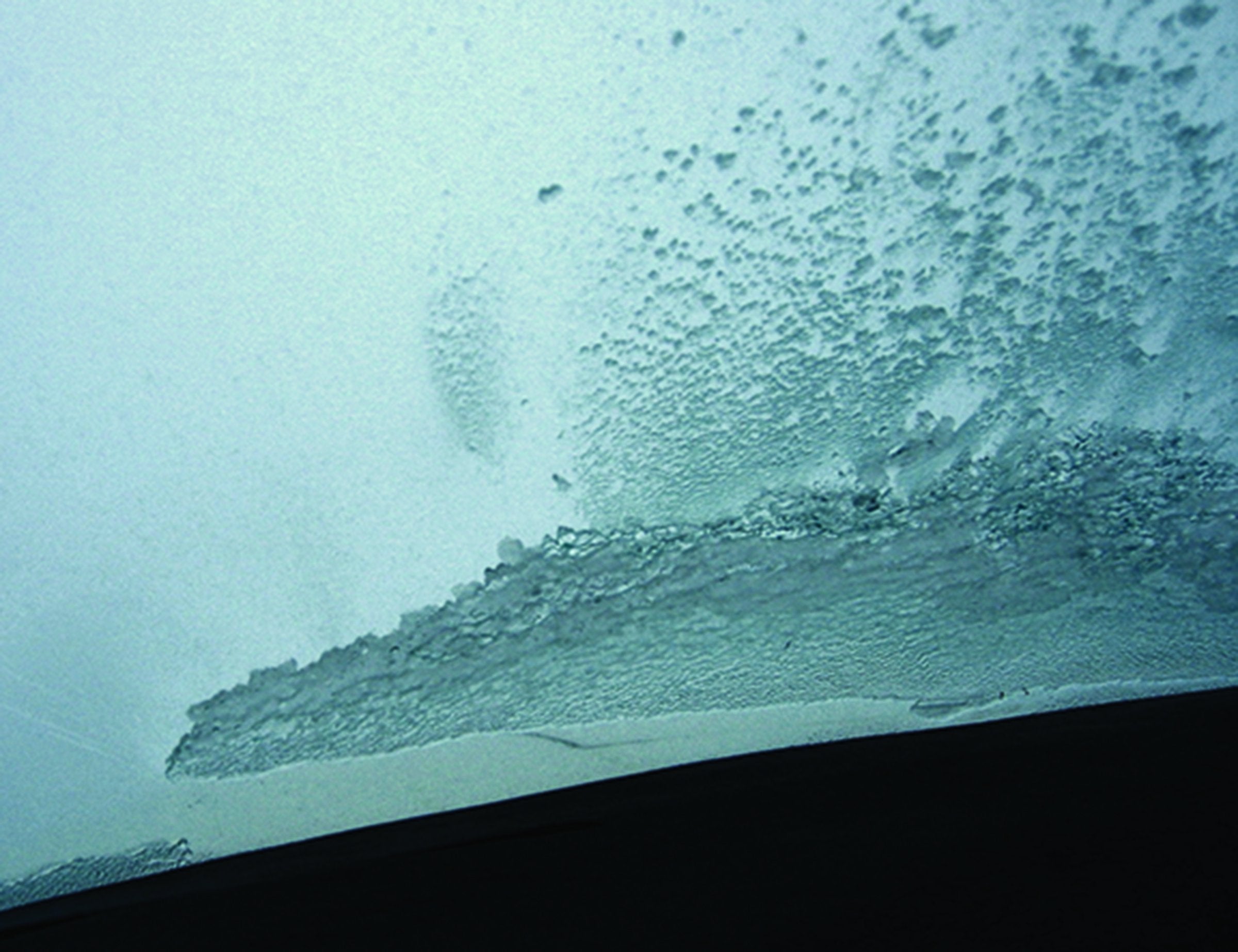

Secondly—and frequently overlooked in discussions of landing with a load of ice—forward visibility can be reduced to nil with only a very slight coat of frozen water. At night or in poor visibility, even small amounts of accumulation on the windscreen can distort visibility, making landing difficult. Regardless of the time of day, it’s very likely that you’ll have to resort to Lindbergh-style peripheral vision out the side windows to flare (such as it is with ice) and land.

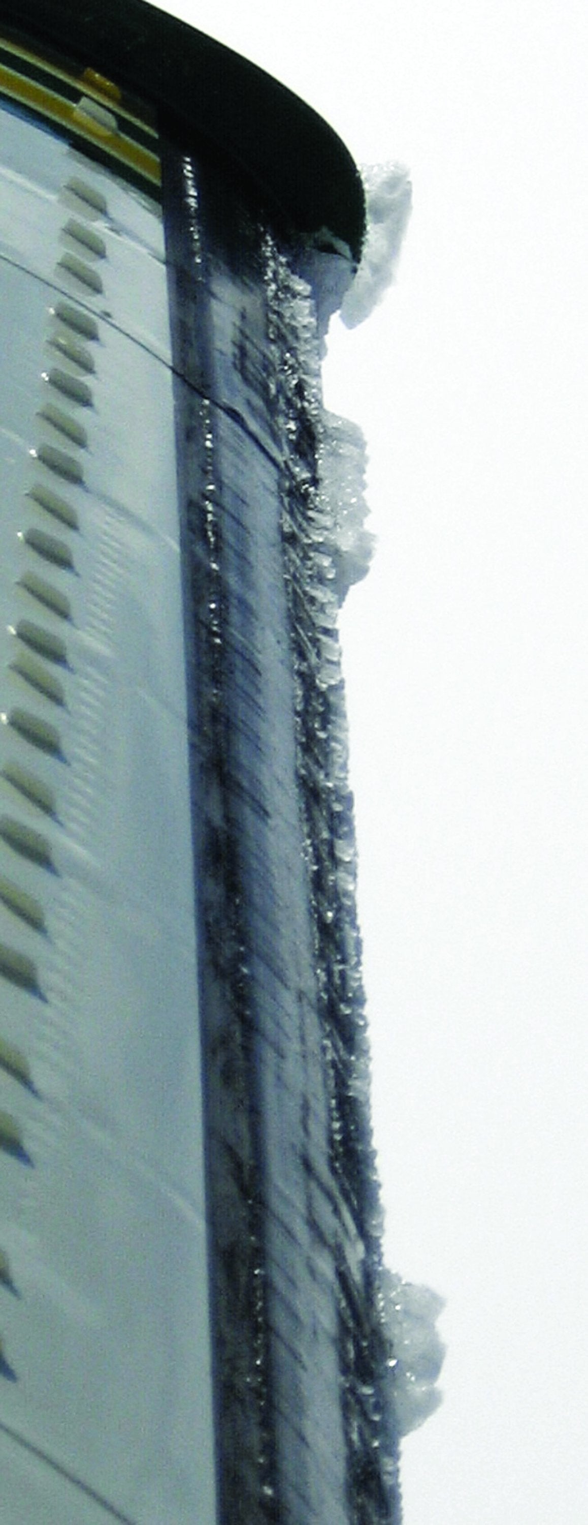

Further, an iced-up propeller becomes less efficient at converting twist into thrust—it’s an airfoil, too—and the wings and tail become aerodynamic unknowns. What has been said about the effects of density altitude on airplane performance goes for airframe ice accumulation as well—you can’t turbocharge the propeller, wings or tail. Rationalizing that power overcomes ice does not hold up if the pilot is unable to escape to an area where ice is shed before descent and landing. By itself, turbocharging is not an ice-avoidance strategy.

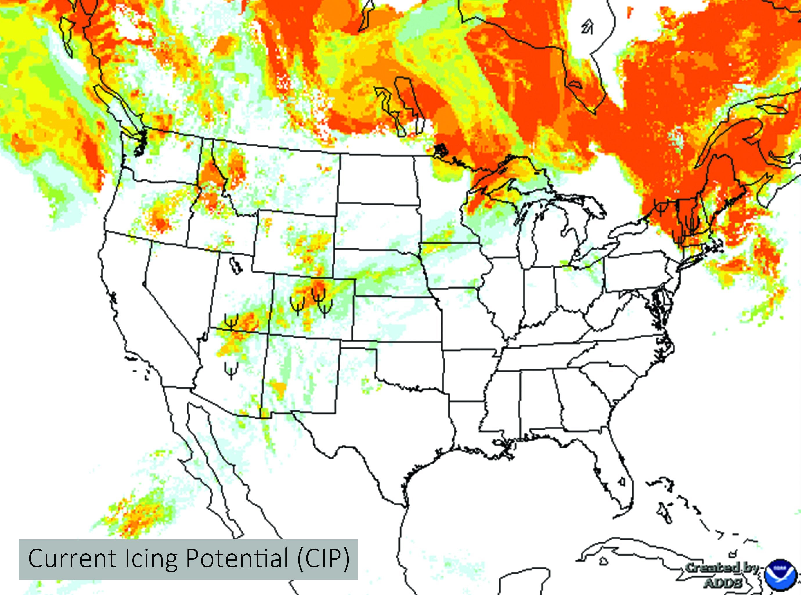

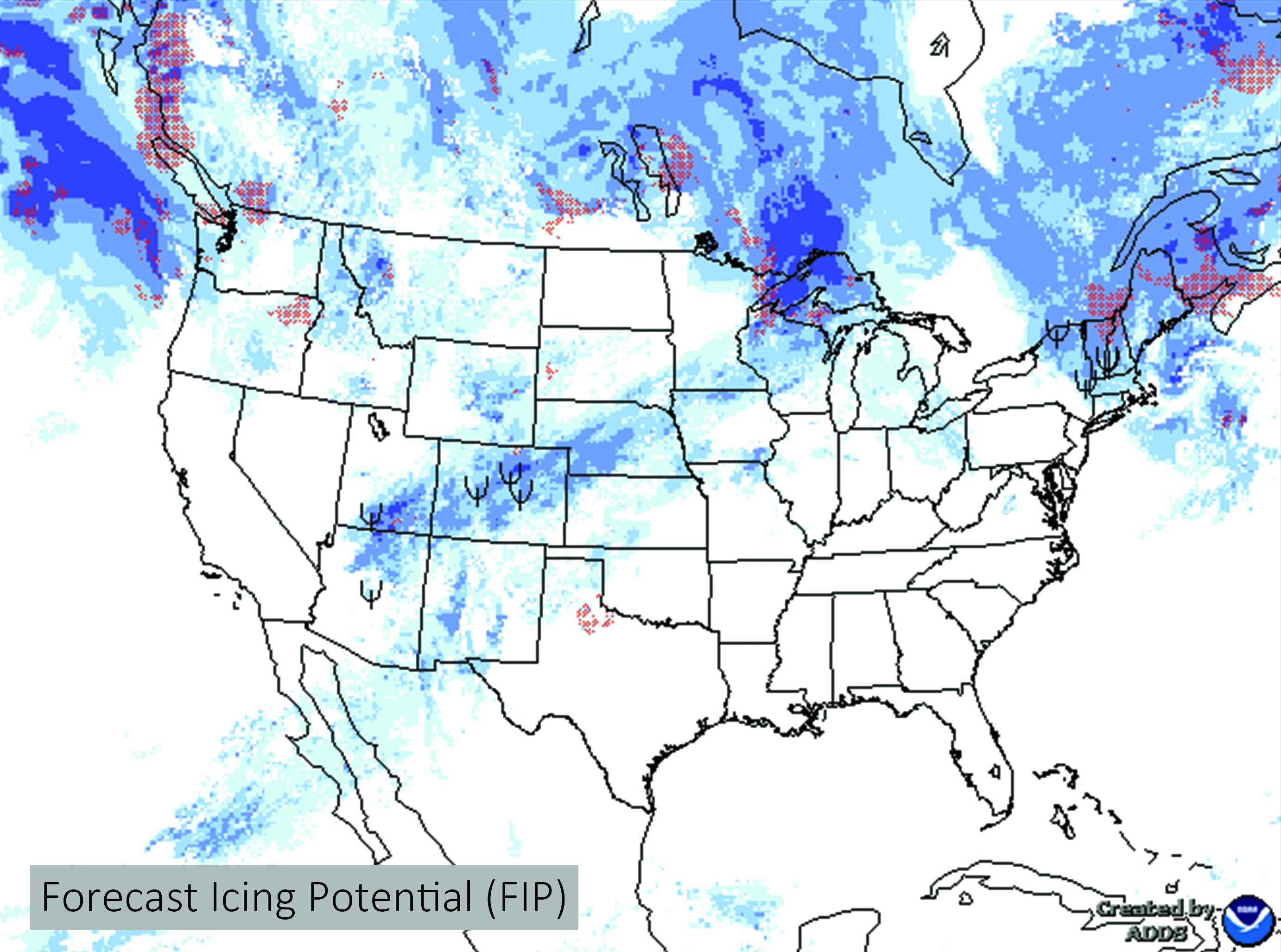

One of the most significant advances in winter-weather risk management in the past few years is the introduction of the current icing potential (CIP) and forecast icing potential (FIP) briefing products. These charts respectively show the likelihood and anticipated intensity of ice accumulation. Some tablet-based flight planning software packages enhance the charts and break them down by altitude to make them even more usable. Some examples from www.aviationweather.gov are reproduced on the right.
Weather information generally has gotten better in recent years, with major improvements in graphics. Icing observations and forecasts got that treatment, too, with the current icing potential (CIP) and forecast icing potential (FIP) charts being an example.
I’ve found the forecast likelihood of airframe ice makes some pilots consider flight where the anticipated accumulation is “light” and the probability of encountering ice is low (less than 25 percent). It’s true that these conditions are less likely to result in a life-threatening ice encounter, but they are still icing conditions—something to avoid in airplanes not certificated for ice, and to be escaped from in a FIKI aircraft if accumulation begins.

Even in a “known-ice” airplane, vision may be severely limited by ice. At its best, a windshield “hot plate” deicer opens only a small rectangle for forward visibility. Often this clear zone is in the center of the windshield, not directly in front of the pilot.

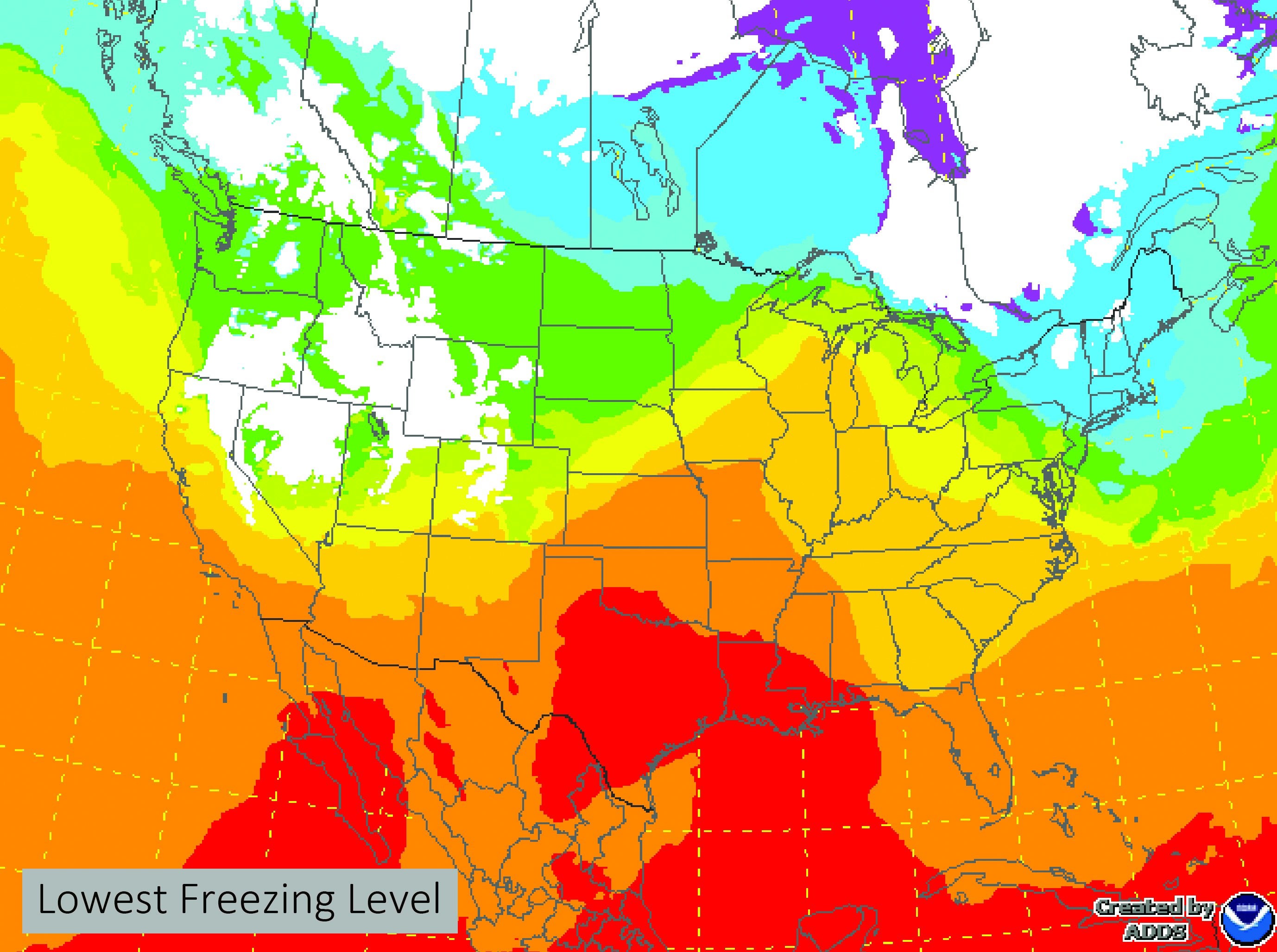

Graphical presentation of the freezing level also helps with preflight planning.

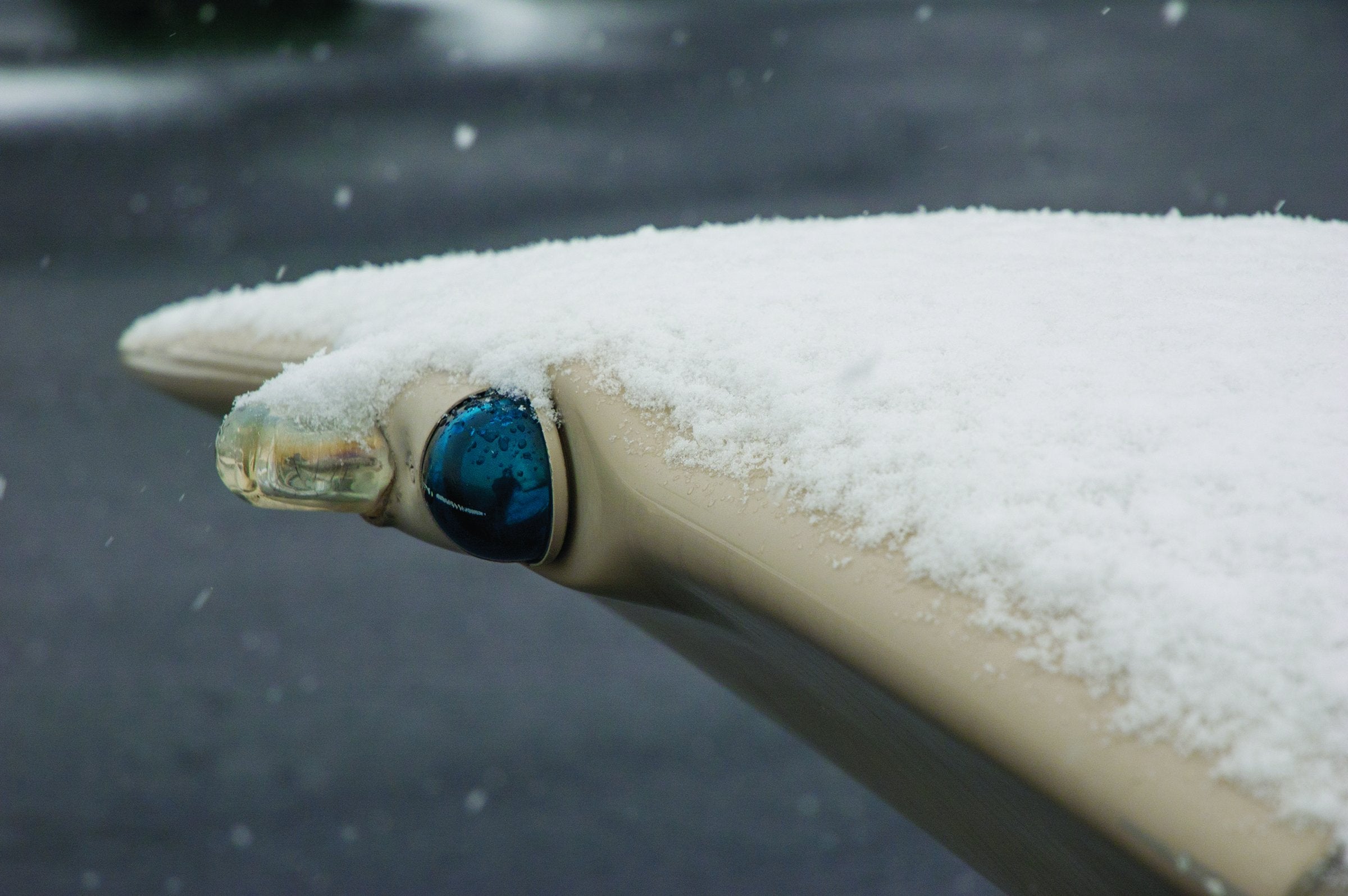

Of course you wouldn’t knowingly take off with snow, ice or frost on the airframe, if for no other reason than it hasn’t been tested. “No airplane manufacturer, nor the FAA, has an established procedure for polishing frost, and the lift and drag penalties are unknown…. Make sure critical surfaces such as lifting surfaces, control surfaces, propeller blades, and engine inlets are free of contamination.”
