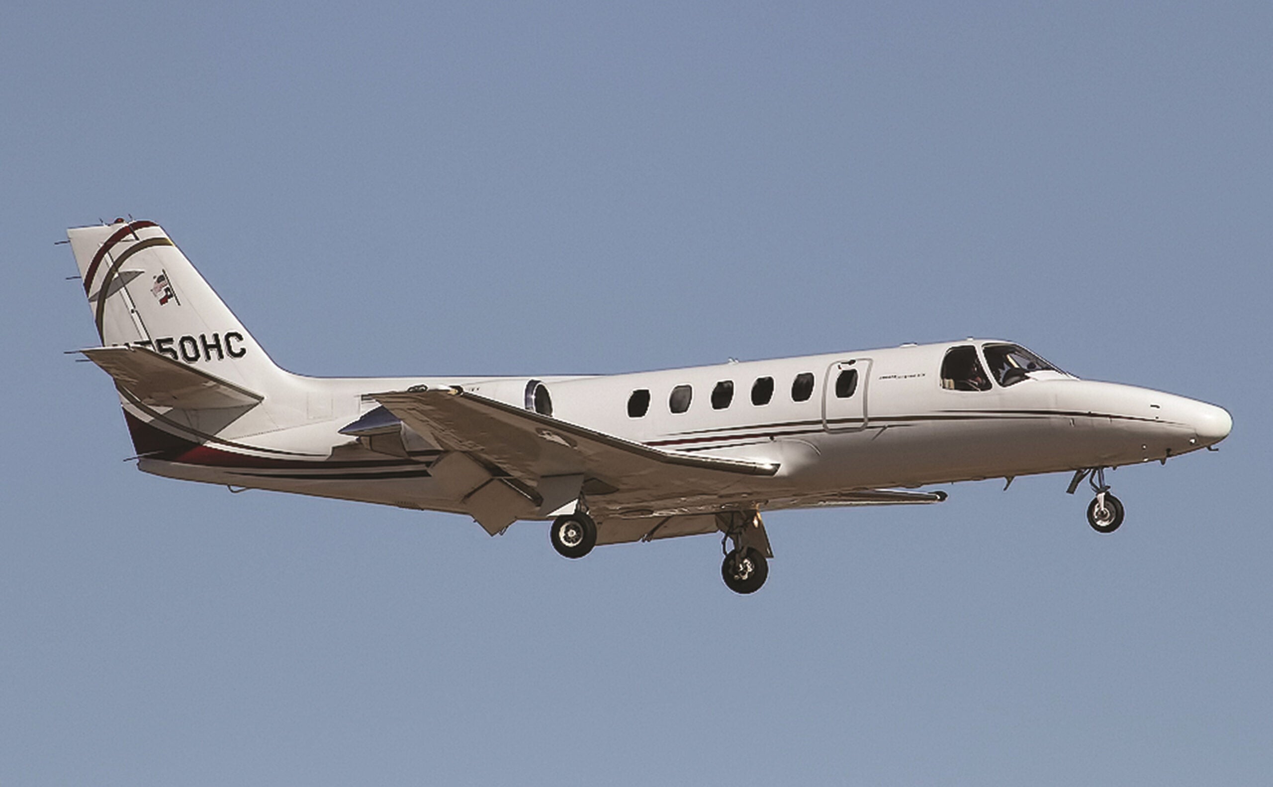

Aircraft Profile: Cessna S550 Citation SII
Image: Bill Word
OEM Engines: P&W Canada JT15D-4B
Empty Weight: 8059 lbs.
Maximum Gross Takeoff Weight: 15,100 lbs.
Typical Cruise Speed: 430 KTAS
Standard Fuel Capacity: 862 gallons
Service Ceiling: 43,000 feet
Range: 1998 NM
VS0: 82 KCAS
