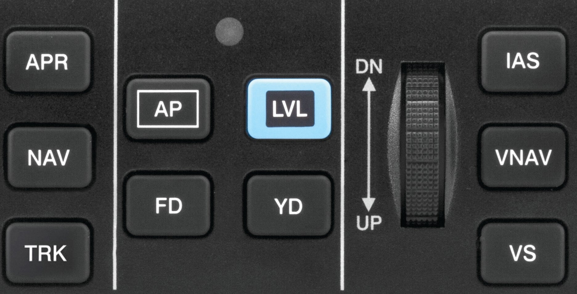

The FAA’s Advanced Avionics Handbook, FAA-H-8083-6, includes a wealth of material on managing the magic in our panels. When it comes to autopilots, the Handbook notes that “some autopilots are capable of automatically switching from one function to another. These automatic mode changes can complicate the task of maintaining mode awareness, but every autopilot has some form of flight mode annunciator that shows which autopilot functions are currently engaged…. It is important to develop two habits:”
  • Checking the flight mode annunciator after entering a command to ensure the desired function is indeed armed or engaged, as appropriate.
  • Including the flight mode annunciator in your instrument and panel scans to maintain awareness of what mode is active and what is armed to activate next.
