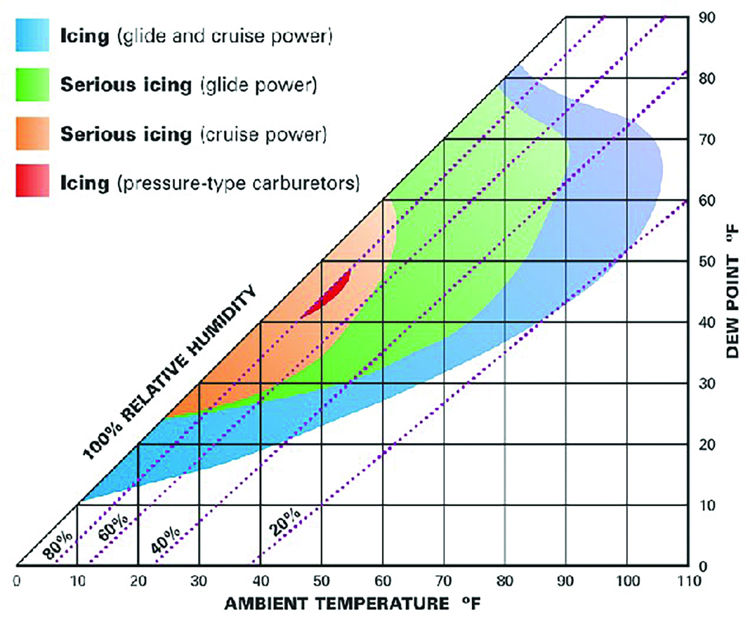

The nearest weather reporting station, about nine nautical miles southeast of the accident site, reported temperature as six degrees C with a two-degree C dewpoint. The FAA’s carburetor ice chart advises this temperature/dewpoint spread is consistent with serious icing at cruise power.

  • Carb heat can melt ice if the accumulation is not too great. Using it as a preventative measure is the better option.
  • If ice is present, applying partial heat or leaving heat on for an insufficient time might aggravate the situation.
  • Carb ice is most likely to form in the temperature and humidity ranges depicted in the chart above, but is possible under other conditions.
  • If carb icing conditions are suspected and closed-throttle operation anticipated, fully apply carburetor heat before closing the throttle and leave it on during the closed-throttle operation.
  • Carburetor heat reduces engine power because the heated air is less dense than the outside air, enrichening the mixture.
  • If ice has formed, full carb heat will further reduce power and may cause extended engine roughness. Carb heat must remain in the full-hot position until normal power returns.
