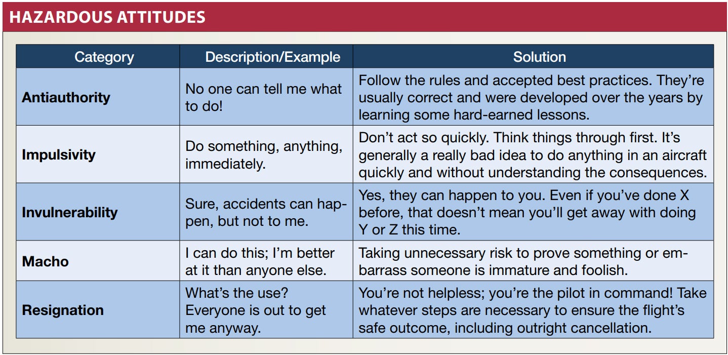

We all know at least one pilot who occasionally displays one or two of the hazardous attitudes the FAA identifies (see the chart below), but it’s difficult to find one who checks almost all the boxes. Now you have.
