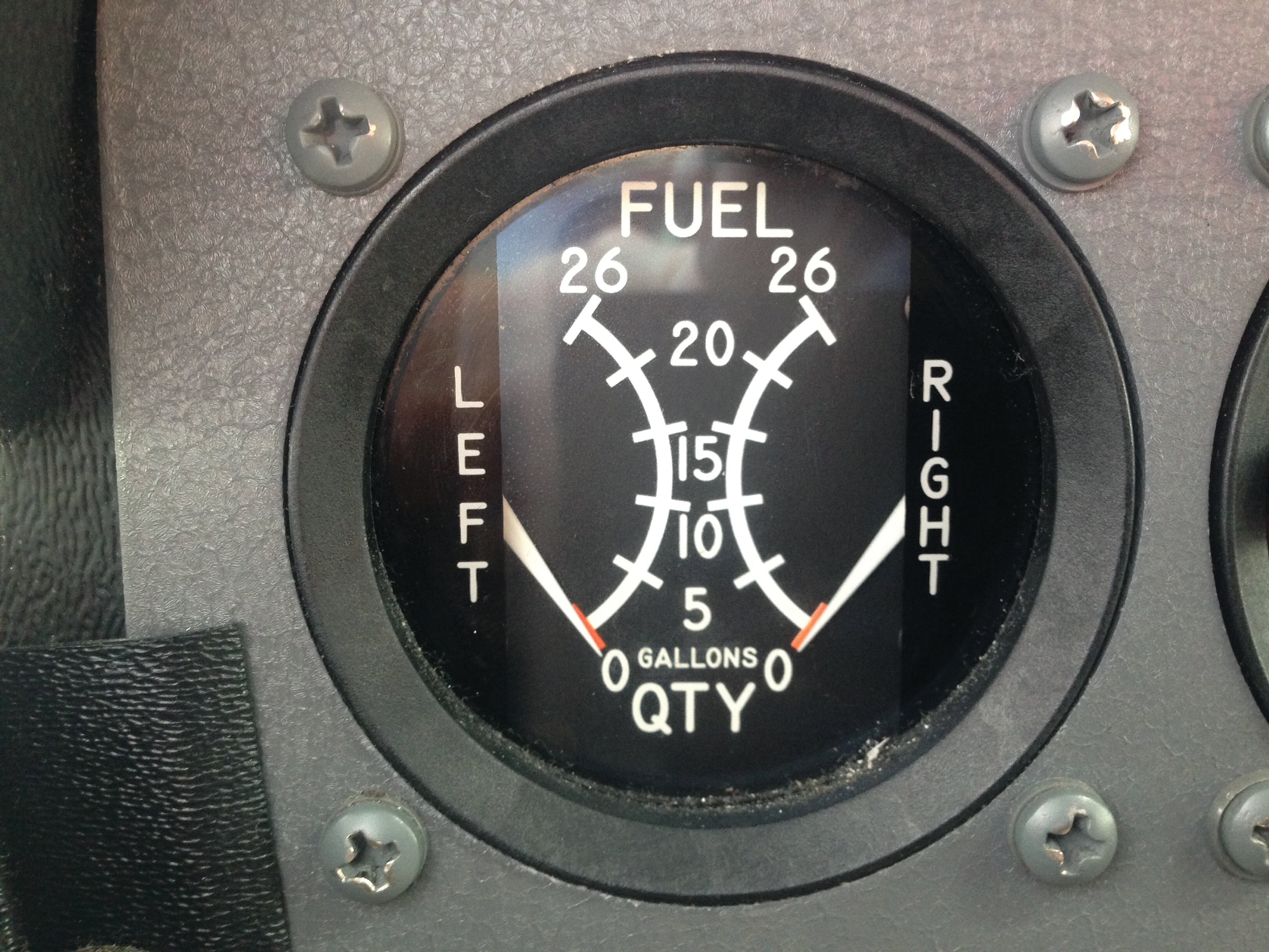

  • Know how much fuel you have onboard AT ALL TIMES.
  • During your preflight inspection, measure and/or visually confirm the fuel quantity aboard. Don’t rely exclusively on fuel gauges.
  • Know how much fuel you will need for a given flight.
  • Make sure you have a fuel reserve for each flight.
  • Know your engine’s fuel burn rate and actively monitor the fuel burn rate for the entire time the engine is operating.
  • Know your aircraft’s fuel system and how it works.
  • Review your aircraft’s POH and use the appropriate checklists.
  • Don’t stretch your available fuel supply. Stop and get gas!
