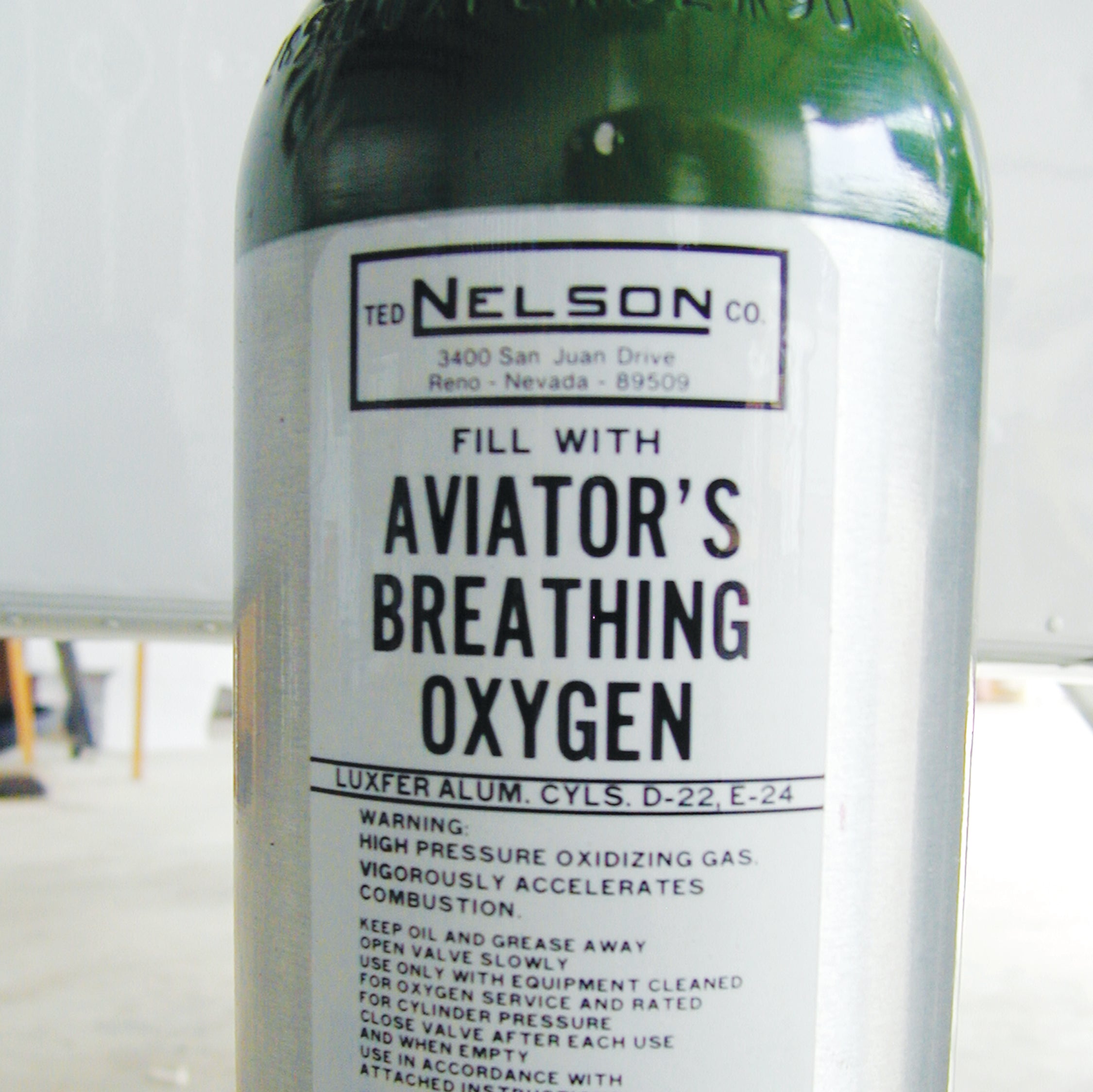

I’m a firm believer in using supplemental oxygen; there’s a portable O2 tank in my airplane right now. For a variety of reasons, I usually go on oxygen when I’m going to be at 10,000 feet or higher for any length of time. I typically fly long legs, and when I use oxygen, I’m not as fatigued as I might have been after the same amount of time at, say, 7500 feet. But higher usually is better for long flights, and O2 is part of my plan.

The left engine showed no evidence of preaccident anomalies that would have precluded normal operation. Its vacuum pump had a fractured rotor, two fractured vanes and a missing drive coupling, and its vane faces showed wear. All damage to the left propeller was consistent with high-impact forces. No oxygen tanks or oxygen masks were in the wreckage.
