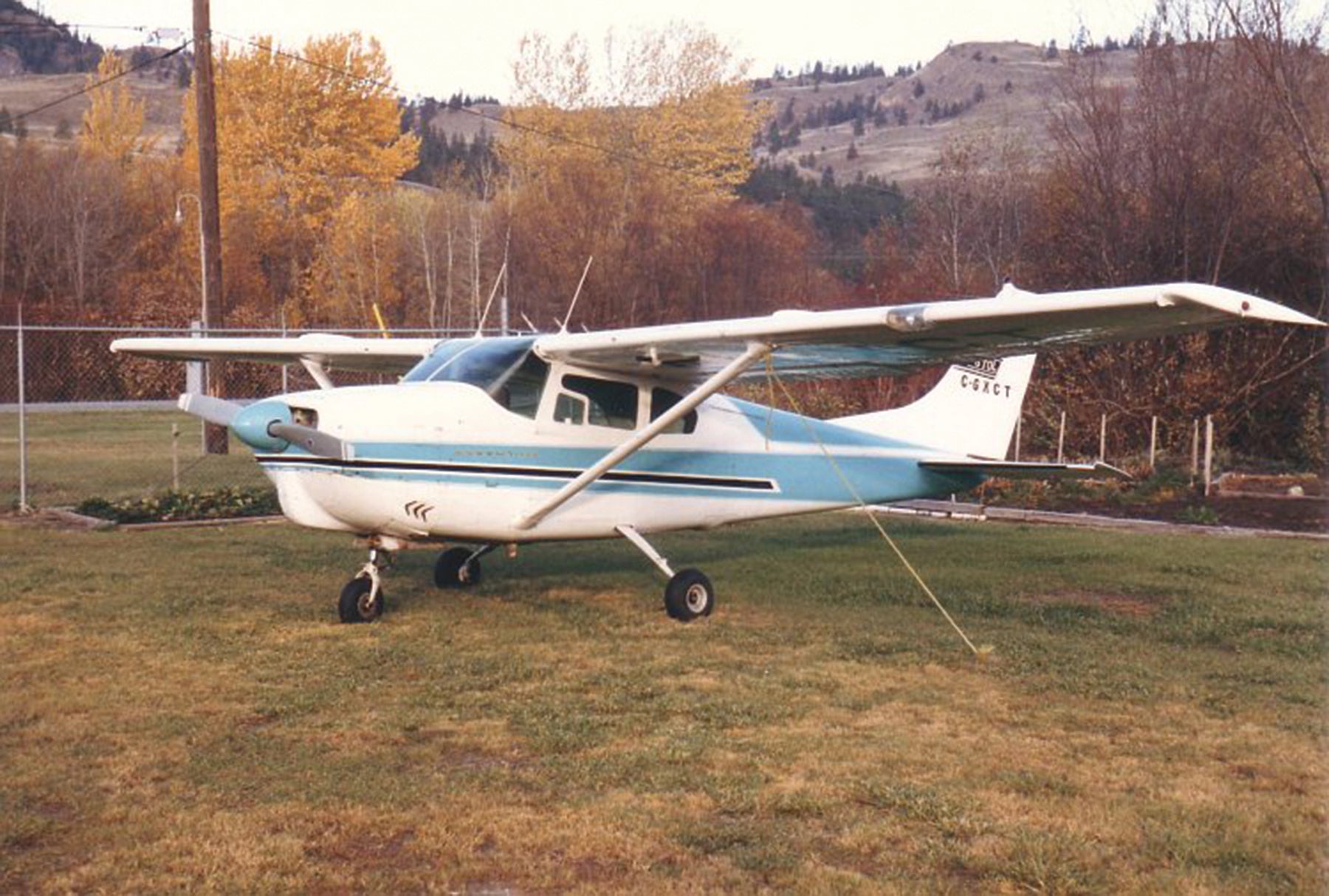

Aircraft Profile: Cessna 210
Not accident aircraft.
OEM Engine: Continental IO-470-E
Empty Weight: 1740 lbs.
Maximum Gross Takeoff weight: 2900 lbs.
Typical Cruise Speed: 165 KTAS
Standard Fuel Capacity: 65 gallons
Service Ceiling: 20,700 feet
Range: 700 NM
VS0: 51 KCAS
