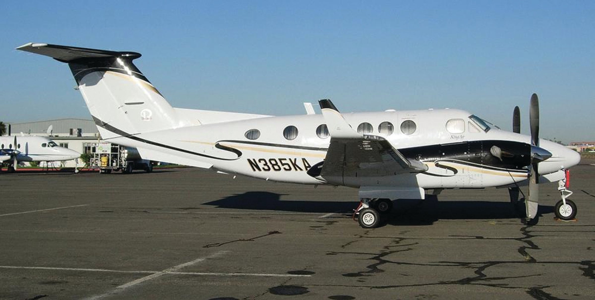

On January 23, 2017, at about 1233 Mountain time, a Beech 300 Super King Air was destroyed when it impacted terrain shortly after takeoff from the Tucson (Ariz.) International Airport. The 56-yearold airline transport pilot and the passenger were fatally injured. Visual conditions prevailed; the airplane was departing on an IFR flight plan to Sonora, Mexico.
A witness about 0.7 mile southwest of the midfield of the departure runway observed the airplane rapidly pitch up during initial climb. At between 100 to 150 feet above the runway, the airplane yawed to the left in a nose-up pitch attitude. The airplane then appeared to slow. It entered a left roll as the nose dropped and the airplane struck the ground inverted.
