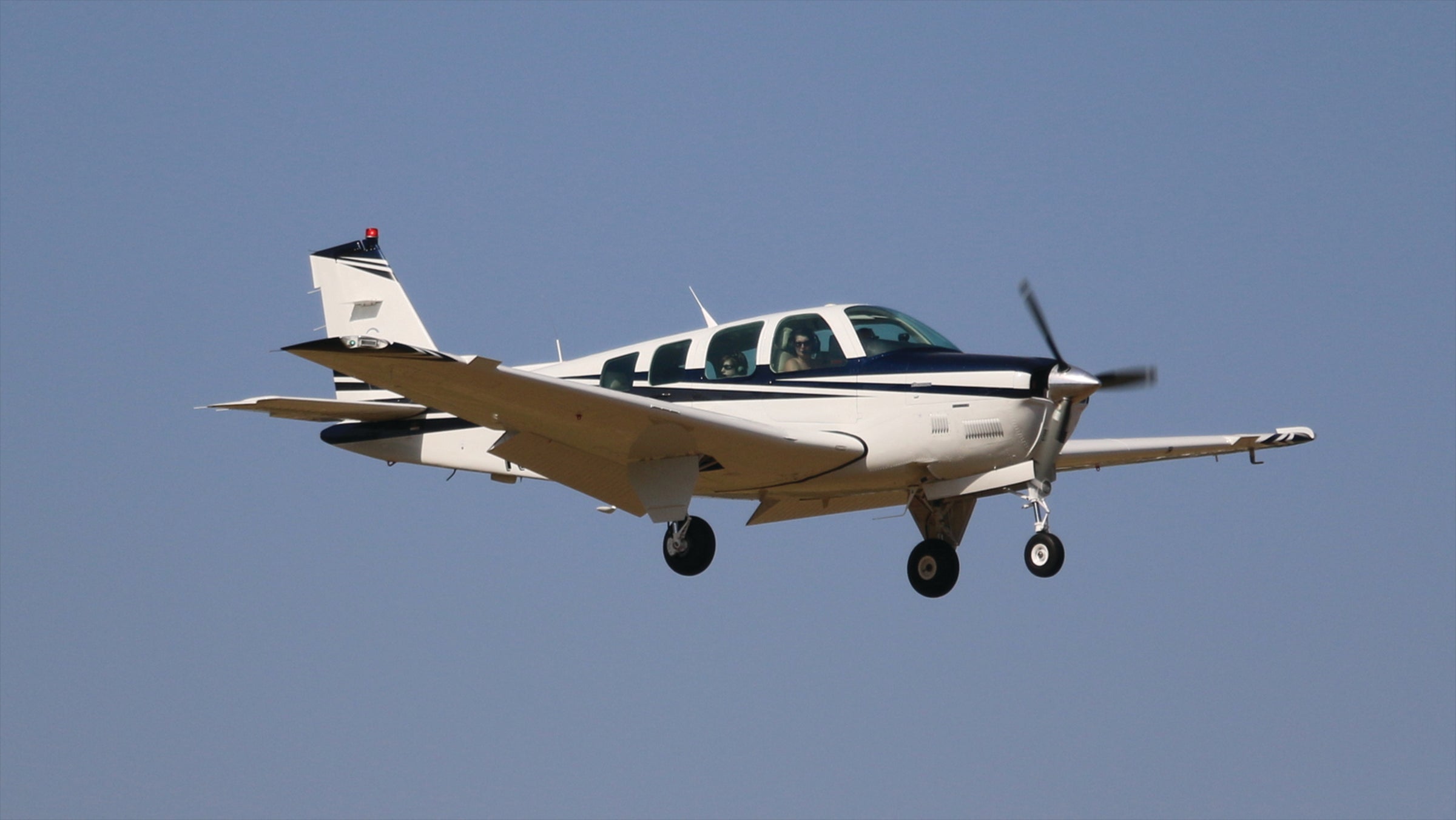

Aircraft Profile: Beech A36 Bonanza
OEM Engine: TCM IO-550-BB
Empty Weight: 2247 lbs.
Maximum Gross Takeoff Weight: 3650 lbs.
Typical Cruise Speed: 169 KTAS
Standard Fuel Capacity: 74 gal.
Service Ceiling: 18,500 feet
Range: 720 NM
VS0: 59 KIAS
