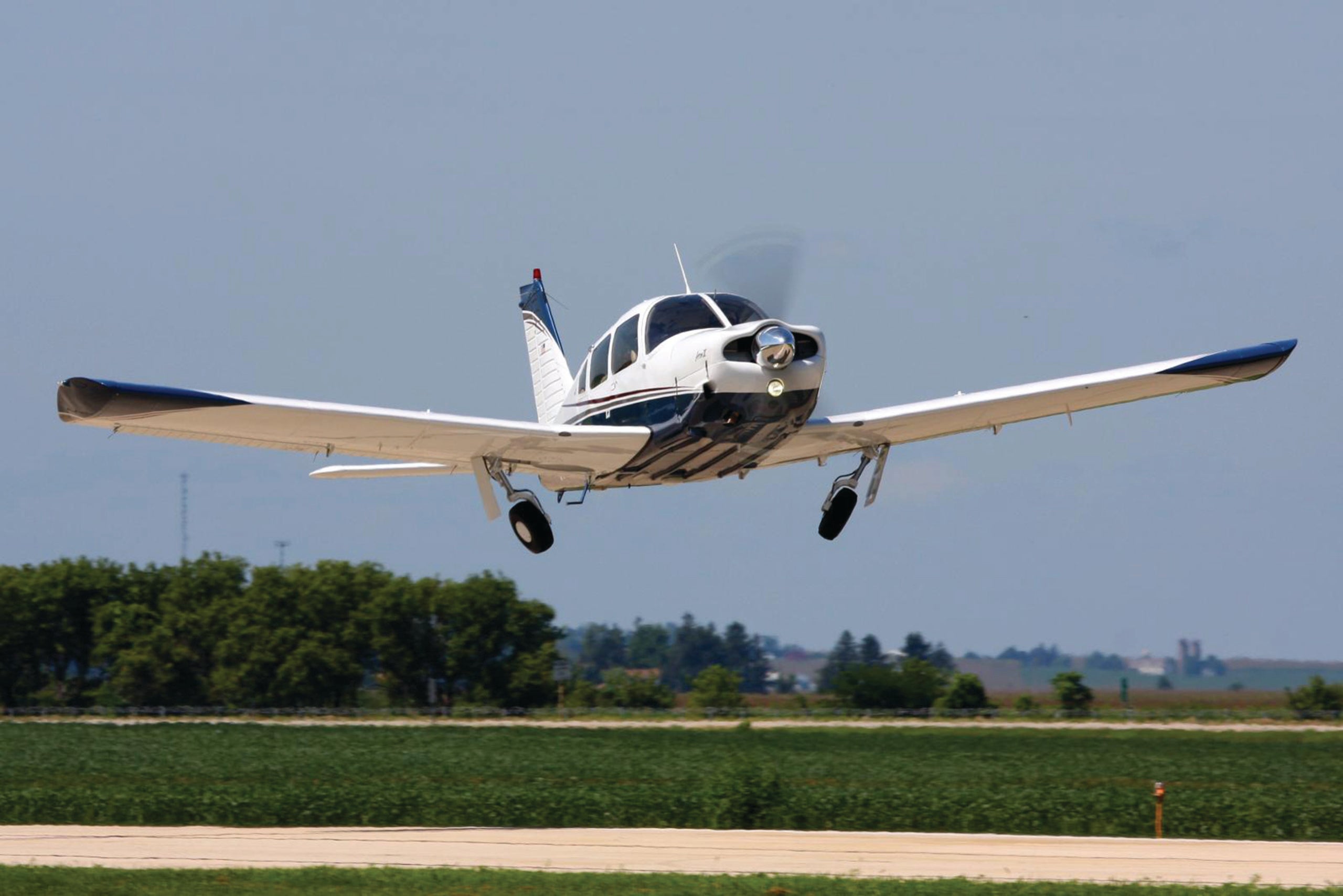

Aircraft Profile: Piper PA-28R-200 Arrow II
OEM Engine: Lycoming IO-360-C1C
Empty Weight: 1523 lbs.
Maximum Gross Takeoff Weight: 2650 lbs.
Typical Cruise Speed: 143 KTAS
Standard Fuel Capacity: 50 gallons
Service Ceiling: 15,000 feet
Range: 600 NM
VS0: 56 KIAS
