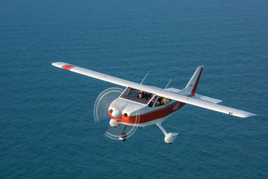

The prototype is powered by a 200-hp Lycoming IO-360 turning a constant-speed prop. Engine options range from 180 to 260 hp.

BD-4C: What’s Old is New Again
The BD-4C, the current model of the BD-4 being sold by Bedecorp, not only has a clean wing, it is larger in a number of key dimensions. The original cabin of the BD-4 was 42 inches wide, about what you find in a Mooney. Yet the BD-4 feels roomier than the Mooney because the sides are flat. The 42-inch width is good from the lower to upper corners—it isn’t wide only at the hips or shoulders. The BD-4C has been widened by 4 inches, making it as wide as a Bonanza, and that is some serious room! Not only is it wider, it is 14 inches longer, providing plenty of cabin space for back seats or, more likely, lots of baggage.
Approaching a BD-4, one’s first impression is often that it is a small and compact airplane. This is probably because it doesn’t sit particularly tall on its gear. But once you get up close and slide into the cabin, you realize just how much room there is for people. The same is true when you take off the cowl and discover just how much firewall width is available. The factory demonstrator is flying with an angle-valve IO-360 and, as they say, “There’s no substitute for horsepower!” With 200 horses fitting neatly under the hood, the BD-4 is ready to go fast and far, given the amount of fuel you can store in a full wet wing.
The basic structure of the BD-4 includes aluminum framing and skins for the fuselage, with honeycomb floors in the cabin area. The main spar carry-through takes up a little room in the cabin overhead, but it is generally forward of a normal person’s head, so it doesn’t cut into headroom. It does limit forward and up visibility for those who are extra tall—but eliminating extra seat cushions will help you to see past that. The wings are fully cantilevered, so there are no struts to add drag or get in the way during ingress or egress. There is, however, a small faired sump (see sidebar) on the lower surface of each wing, just outside the swing of the door. This is to make sure that fuel will feed no matter the pitch attitude. But it also serves to collect the noggins of those not paying attention walking underneath the wing—so be careful and keep your eyes open!
