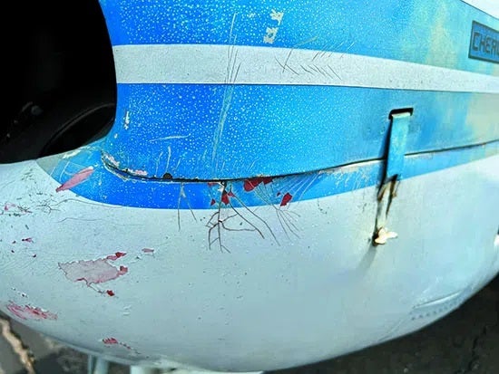

Cowlings absorb a lot of vibes and it takes a close inspection to determine whether cracking is isolated to the paint's surface or runs skin deep. Regardless, don't let it progress to the extent it has on this weathered Piper.

During routine inspections, good technicians dig deep into the airframe looking for structural cracks. And if you’re doing even a causal preflight walkaround it’s not uncommon to find cracks around cowlings, windows and fairings. None of them should be ignored.
Surface cracking doesn’t usually mean a cowling or control surface will come apart, but it’s a clue that weather and vibration are taking a toll. Short of replacing major structural and cosmetic parts, quality repairs are possible and acceptable practice when using the right guidance. Here’s a short primer.
