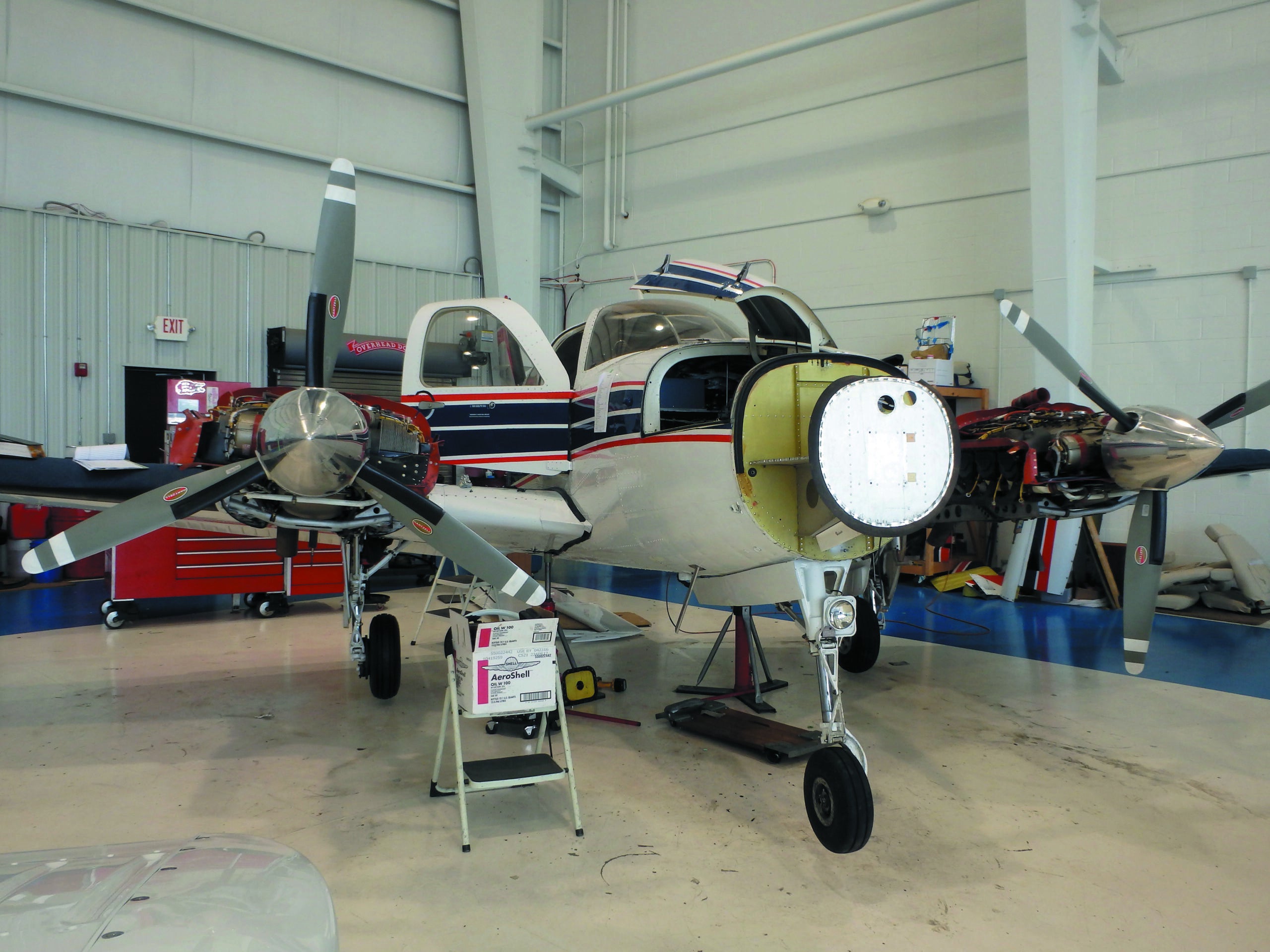

With a slowed supply chain, airplanes are spending more time in pieces on shop floors.
  • Aircraft annual inspections often escalate from routine checks into extensive, costly repairs or overhauls due to unforeseen issues.
  • Clear and consistent communication between the aircraft owner and maintenance shop is vital to prevent misunderstandings and effectively manage project scope.
  • Major maintenance projects are prone to significant delays and cost overruns from external factors (e.g., supply chain, specialized vendors, shop closures) and can result in new issues upon reassembly.
