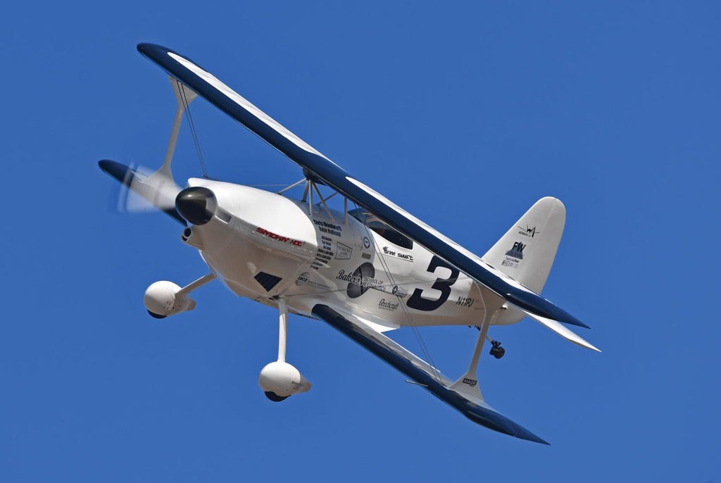

Three times the Biplane Gold class winner, Smokin’ Hot, née Bad Mojo, is a seriously fast biplane. Had it not been for the radically modified Mong Sport Phantom redefining “racing biplane,” this white Pitts would be the runaway talk of the Biplane class. Best speed to date is a 224 mph race average (Photo: Tim O’Brien)
  • The Pitts Special, now known as "Smokin' Hot," has a long history of transformation from a stock aerobatic plane built in 1978 into a champion air racer through significant modifications by multiple owners.
  • Bob Bryson initiated major aerodynamic changes like new wings and a Knight Twister tail, while Jake Stewart further optimized its performance with extensive engine hot-rodding and critical stability improvements, turning a dangerously handling plane into a top competitor.
  • Current owner Sam Swift purchased the plane (formerly "Bad Mojo") in 2022 and immediately won the Biplane Gold championship at Reno, marking the airplane's third such victory and continuing its legacy of racing success.

First owner to speed-mod the plane, Bob Bryson retained the stock Pitts fuselage dimensions and weldment, but skinned the fuselage sides and turtleneck in carbon fiber. He also rebuilt the wings still in use today.
Bryson’s modifications included rebuilding, or more accurately, replacing, the wings. Using a Sparcraft kit, Bryson modified the airfoil to his own semi-symmetrical shape using custom-built ribs and clipping the wing assemblies to a seriously short 14 feet 2 inches. No doubt looking for aerodynamic stiffness, he then skinned the wings with carbon fiber, only to quickly remove the wonder material in favor of reapplying fabric covering. The four leading edges were also modified; normally skinned in thin aluminum or molded plywood (the latter stiffer but typically a test of a builder’s skills and patience), Bryson covered his leading edges with Kevlar he had shaped in a mold. He chose the yellow fabric over carbon fiber because Kevlar doesn’t shatter under impact loads (think bird strike) as does carbon fiber.
Additionally, Bryson removed all dihedral from the lower wings, which in turn necessitated longer interplane I-struts.
Handsome from any angle, Smokin’ Hot speeds up the usual frumpy Pitts lines by taking the sag out of the belly, sporting a tall Knight Twister tail and a narrow-entry carbon fiber cowling built by Jake Stewart in 2018–19.
Wanting to dispense with the draggy, externally braced Pitts tail group, Bryson amputated it in favor of a Knight Twister arrangement. This was a set of all-new vertical and horizontal surfaces built to Knight Twister plans and skinned in carbon fiber. The necessary mounting tabs were welded to the Pitts fuselage to accept the Knight Twister transplant and the result was a big increase in speed.
Another Bryson mod was this lowered, tinted canopy. Interestingly, both Jake Stewart and Sam Swift say the dark tint is never a bother and never even notice it.
Bryson also spiced up the engine a bit and was likely the one who replaced the original red paint with white, given that he had changed so much of the little Pitts’ surface area.
