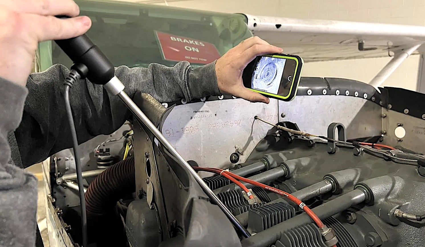

Examining a cylinder with a borescope is the gold standard for determining cylinder condition. Borescope prices have dropped dramatically while capabilities have shot upward, including the ability to put the image on a smartphone, as shown here.

The best way to determine the cause of air leakage past the valve is the borescope exam. It will determine the extent of the damage to the exhaust valve and how we’ll the valve is seating. Bottom line, cylinder removal is only appropriate if the valve is so badly burned that it’s not a good candidate for lapping.
Savvy recommends borescope inspections of all cylinders every 100 hours (50 hours for turbocharged engines). It is Savvy’s position, and we agree with it, that doing a borescope exam at the recommended intervals is frequent enough to detect “a burning exhaust valve, failing rotocoil, detonation signatures or other developing cylinder issues before they reach the point of causing an inflight power loss and often early enough that cylinder removal can be avoided.”
Modern borescopes provide high-resolution imagery that can be viewed and stored on a number of devices.
Which Borescope?
The great news is that there are an amazing number of high-quality borescopes on the market for under $300. As far as we’re concerned, that means that no shop should be without one—that goes for maintenance-involved owners as well.
