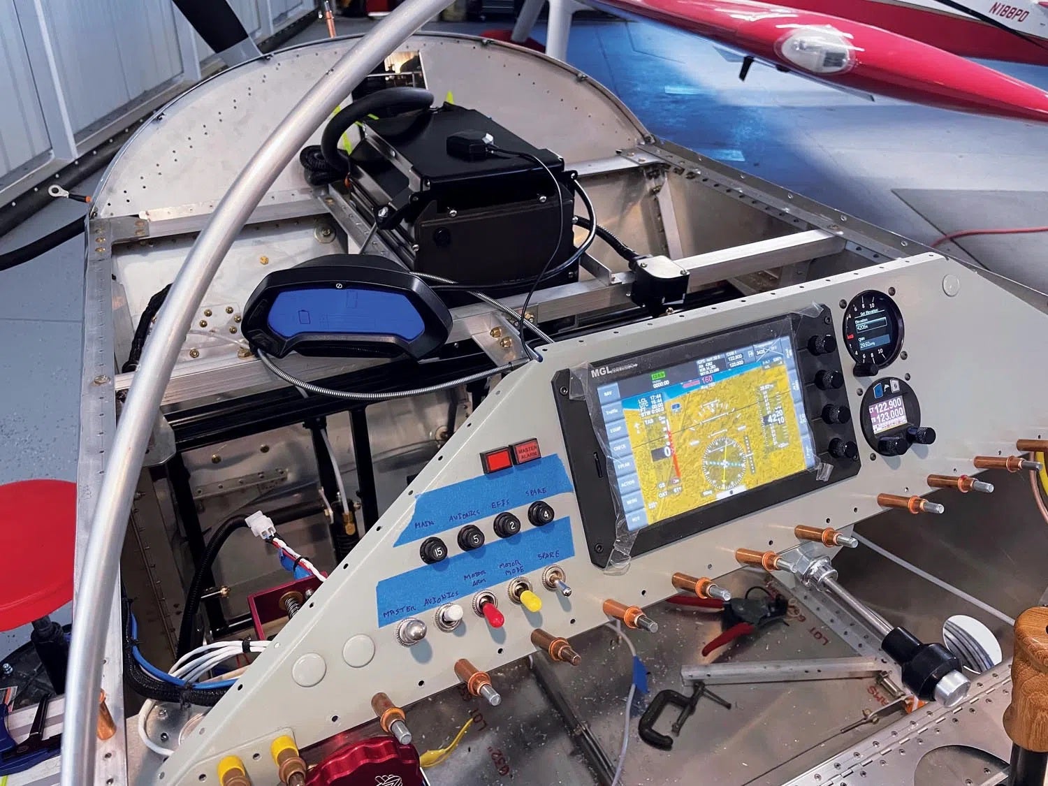

The power system installation is complete, with the main battery powering the ship’s avionics through the DC/DC converter. Toggle switches are used in place of the motorcycle switches for Master, Motor Arm and Mode control. Additional toggles are for avionics power and a spare (for future lights).

The battery charger is heavy, so a robust mount was built that utilized the motorcycle yoke and tension bolts (left). The battery charger and display wiring were run through a hole in the bottom of the firewall doghouse (right).

The charge tank is an optional high-speed charger provided by Zero for the motorcycle. It mounts in the empty (fake) fuel tank on the bike and was creatively designed by the motorcycle engineers to attach like a battery—it sits in a cradle and is held down with a mounting strap and two long J-hooks. This works really well on the bike but, unfortunately, provides no mounting flanges or hole with which to attach it to the aircraft. Our chosen location was behind the firewall, above the pilot’s and passenger’s legs, meaning that we had to figure out a way to suspend it there—making it a very interesting challenge.
The answer was to simply go with the flow and build an analog to the motorcycle’s cradle, then use the bike’s mounting strap and J-hooks. We did this by first installing a 1.5×1.5-inch aluminum angle across the cockpit, forward of the instrument panel, right where the original Xenos fuel tank strap mounts. We then fashioned two aluminum angles that spanned the space (fore and aft) from the top forward edge of the fuselage tub and that new cross angle. These two angles were the support members for a sheet metal cradle that fit the charge tank and suspended it in the space. We added bottom angle stiffeners to make the cradle very rigid, then riveted on aluminum angle “ears” where the J-hooks could attach. Riveted all together, it made a nice structure with no flex—a good way to mount the heavy charger. The cradle was bolted in place at the four corners to the cross-fuselage members, and the wiring from the front of the charger went through the opening in the firewall previously used by the fuel tank filler neck.
A bracket was built to support the charge plug inside the firewall doghouse—right where the fuel filler is located on a standard Xenos.
