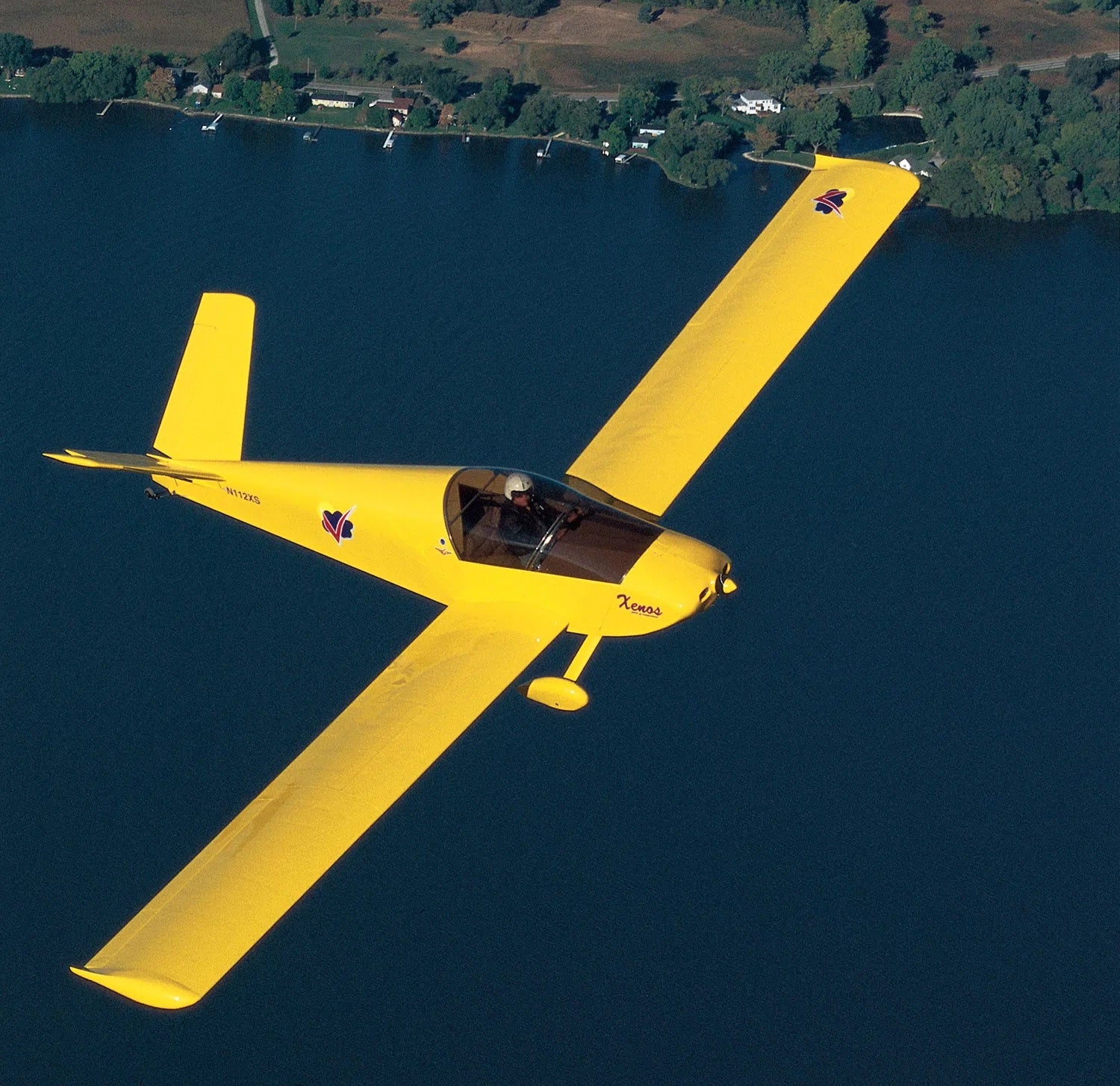

The factory Xenos (front) compared to its smaller brother, the Waiex. They use the same cabin, but the wings and tail are longer, and the tail surfaces bigger.
