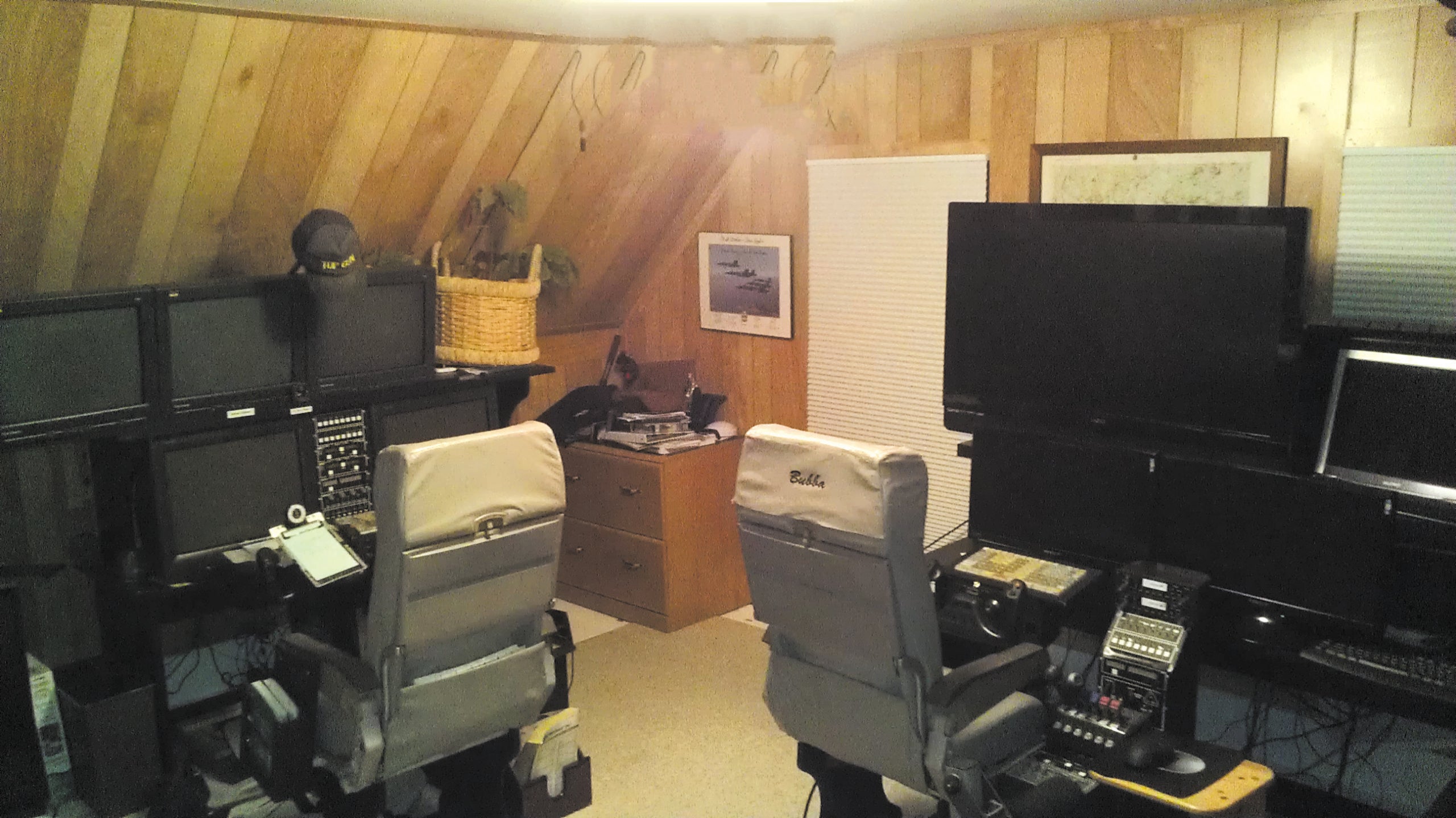

Frank Bowlin has a dedicated, air-conditioned and heated simulator room in his hangar that’s just waiting to house a simulator.
