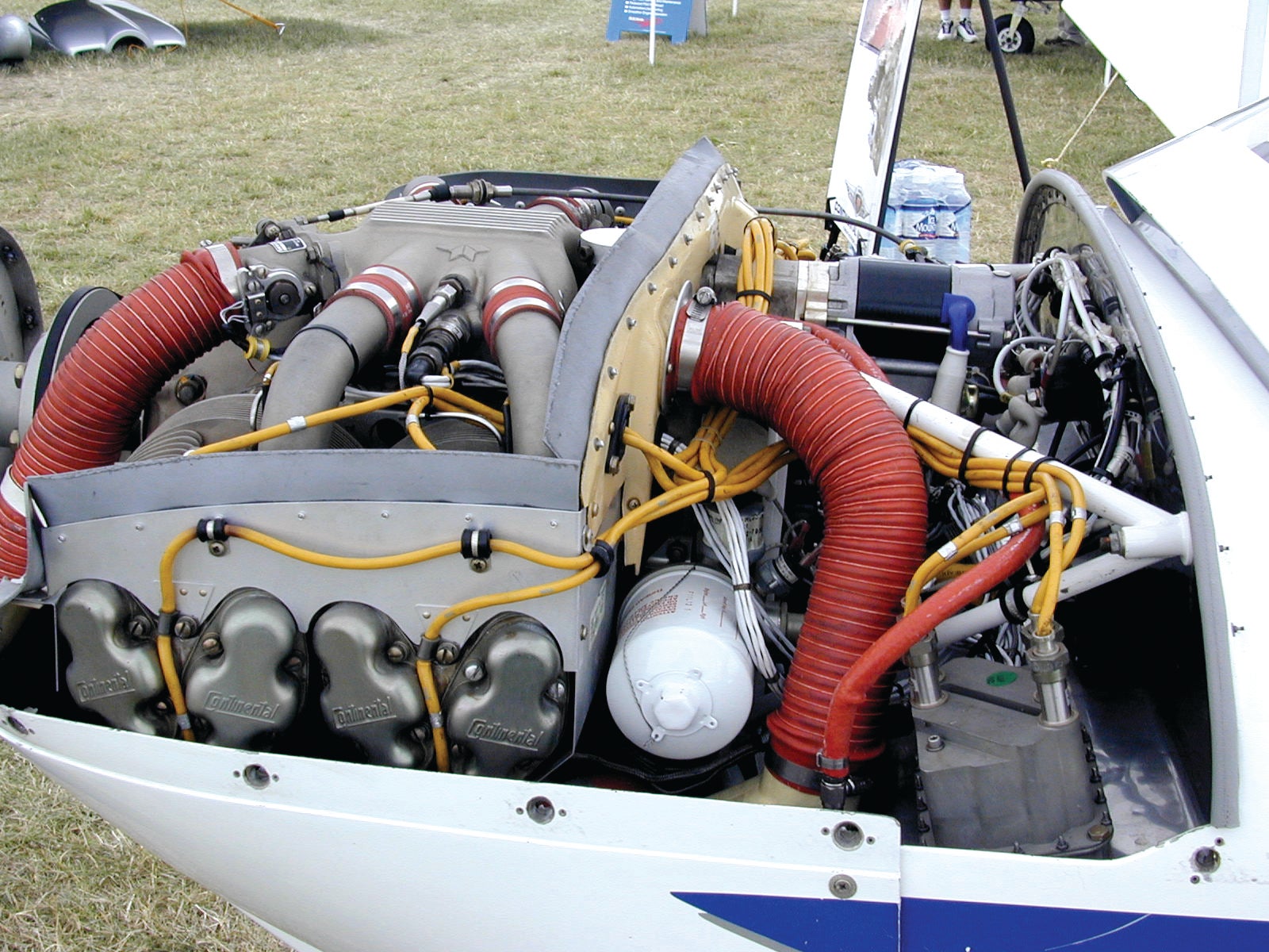

By the time you read this, my Debonair should have a freshly overhauled engine holding down its nose. The story of how all that came to be is best told with a few adult beverages, but the bottom line is I will soon have a new hole in my wallet and a zero-since-major-overhaul IO-520.
This isn’t my first engine overhaul with this plane, but it has been a while, so I sat down recently to review how I handled the previous one, update myself on the various recommendations and develop a plan for the plane’s next few flights. I came away with new appreciation and respect for test pilots.
Infant Mortality
In my case, the result pretty much will be a firewall-forward overhaul or replacement of everything. Last year at annual, I had the exhaust and propeller sent out for inspection and repair as necessary, an IRAN. After the engine is reinstalled, everything else except the wet vacuum pump and the baffling will be new or overhauled. This actually increases the risks the first few flights pose. It’s called “infant mortality,” which describes the fact that new components can have a higher failure rate than those already in trouble-free operation. Ever had a new product fail out of the box? Same thing. So there’s more going on here than just breaking in some new cylinders.
The description of new or overhauled components reads like a parts list, which it basically is. In addition to the nuts, pins, clamps bolts, washers and rings required to keep a piston engine from tearing itself apart, there are new spark plugs, a harness kit, overhauled magnetos and fuel system, and even an overhauled starter. (The last overhauled starter on this engine gave up after way too few starts; it was replaced with one pulled from an in-service engine and never gave me a problem. Go figure.) The shop handling the engine’s installation also will be adding new hoses and engine mounts. So if anything can go wrong, it likely will in the first few hours of operation, at least until everything gets up to operating temperature a few times and all the bits learn to work and play well with one another.
All of which argues for much more caution in the first few hours of flight than with an in-service engine. I’ve got a plan for that, which is summarized in the sidebar “New Engine Test Flight” below. Basically, it comes down to keeping everything cool and staying over the airport for a couple of flights to check for leaks, and to have a runway ready in case someone forgot a cotter pin.

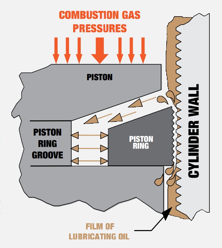

The graphic at right shows why, and what’s going on in the cylinder itself. A new cylinder’s wall typically is honed before installation, leaving the surface relatively rough. New rings have a similar finish. To properly seal the piston/cylinder interface, these two surfaces need to be worn down during initial operation. The trick is to force the rings against the cylinder walls during the break-in process, minimizing lubrication.
This is best accomplished by running the engine at high power settings, which generate the highest internal cylinder pressures, maximizing both ring expansion against the cylinder walls and friction. This naturally generates greater heat than normal. This part of the break-in process can be considered complete when cylinder-head temperatures stabilize.
