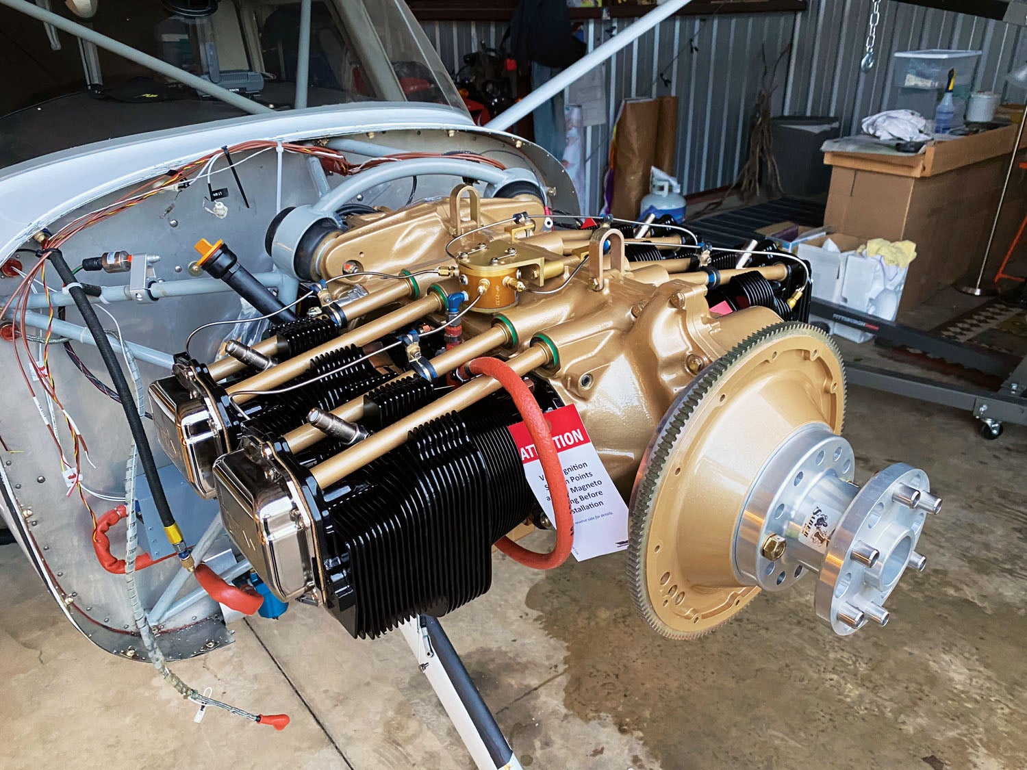

My next-door hangar neighbor, GlaStar builder and KITPLANES® web manager, Omar Filipovic, had already cast his steely gaze upon the Titan IO-340 hanging from my GlaStar’s nose. A few days before “the event,” I had mechanic friend Will Steenrod pop over to provide another set of eyes. His expertise involves cars and motorcycles—as a factory-trained wrench for multiple brands—but I know him to be meticulous and curious. He could be counted on to apply a critical eye to my work without preconceptions about how stuff is “usually” done in aviation.
And still, with the GlaStar sitting in the sunny space between hangars at my home base of Twin Oaks Airpark, Omar standing ready with the fire extinguisher, I felt the shimmer of anticipation and concern. What had I missed? How will it go? The moment of truth to prove the rightness of making so many changes at once—old O-320 to spanky new Titan IO-340—had come and I was, yes, just a titch nervous.
But there was no obvious reason to wait. Besides, this Titan had already been run on the factory dyno for 3 hours, so I wasn’t the first to bring the engine to life. No, someone in Alabama had already done that, probably acting careful/routine and not feeling nervous at all. Another day in the life…
Still, for me this moment was at the end of a lot of integration work. Some of it more “cookie cutter” than wheel-reinvention, but there was still enough raw fabrication and one or two places where I had to put my experience prototyping and best-guessing to the test.
Why is this man holding a hammer? Omar Filipovic (right) helps your EIC fit the new engine mounts to the Titan IO-340. Sometimes strategic force is required.
