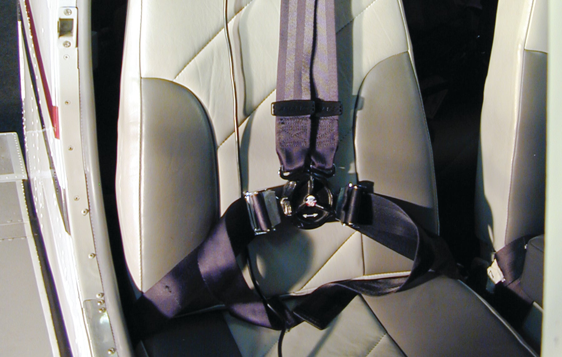

The four-point harnesses in my Debonair didn’t come from the manufacturer but were installed using an after-market factory kit. Field installation required drilling and rivets, but the end result looks factory-designed, which it is.

When I bought my Debonair from its previous owners, it had the original factory lap belts installed. As someone who had been flying airplanes equipped with three-point harnesses, it felt very exposed to be zooming around in something almost three times as fast as the car I drove to the airport but without even a shoulder strap to restrain me in the event “something” happened. One of the first upgrades I made to the plane was to add a set of four-point belts and harnesses to the front seats, and I’m happy to report I’ve never had to perform a real-world test of their effectiveness.

Four-point restraint systems will feature a strap over each shoulder, plus two lap belts, fastening to a central buckle. A five-point system adds a crotch strap, anchored to the seat, which helps prevent the lap belt from riding too high on the wearer’s torso.
Each of these types can incorporate an inertial reel that allows the shoulder straps to retract when not in use but which also locks when significant force is applied, again just like your modern car. The four- and five-point systems can be equipped with a rotary buckle that releases all belts with one quick twist, or you can opt for a more conventional metal-to-metal buckle with a latch. If you’ve ever flown in a war bird or an aerobatic aircraft, you may be familiar with the over-center-latch style of buckle, with a longish lever that tightly locks the belts down using a cam arrangement.
