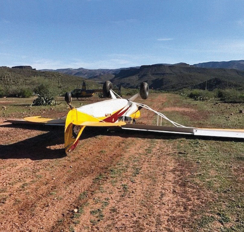

Red Creek is an uncharted strip near Payson, Arizona. Not for the inexperienced, it’s not only short (1200 to 1400 feet, depending upon the source), but its steepness and rising terrain to the west require one-way operations.

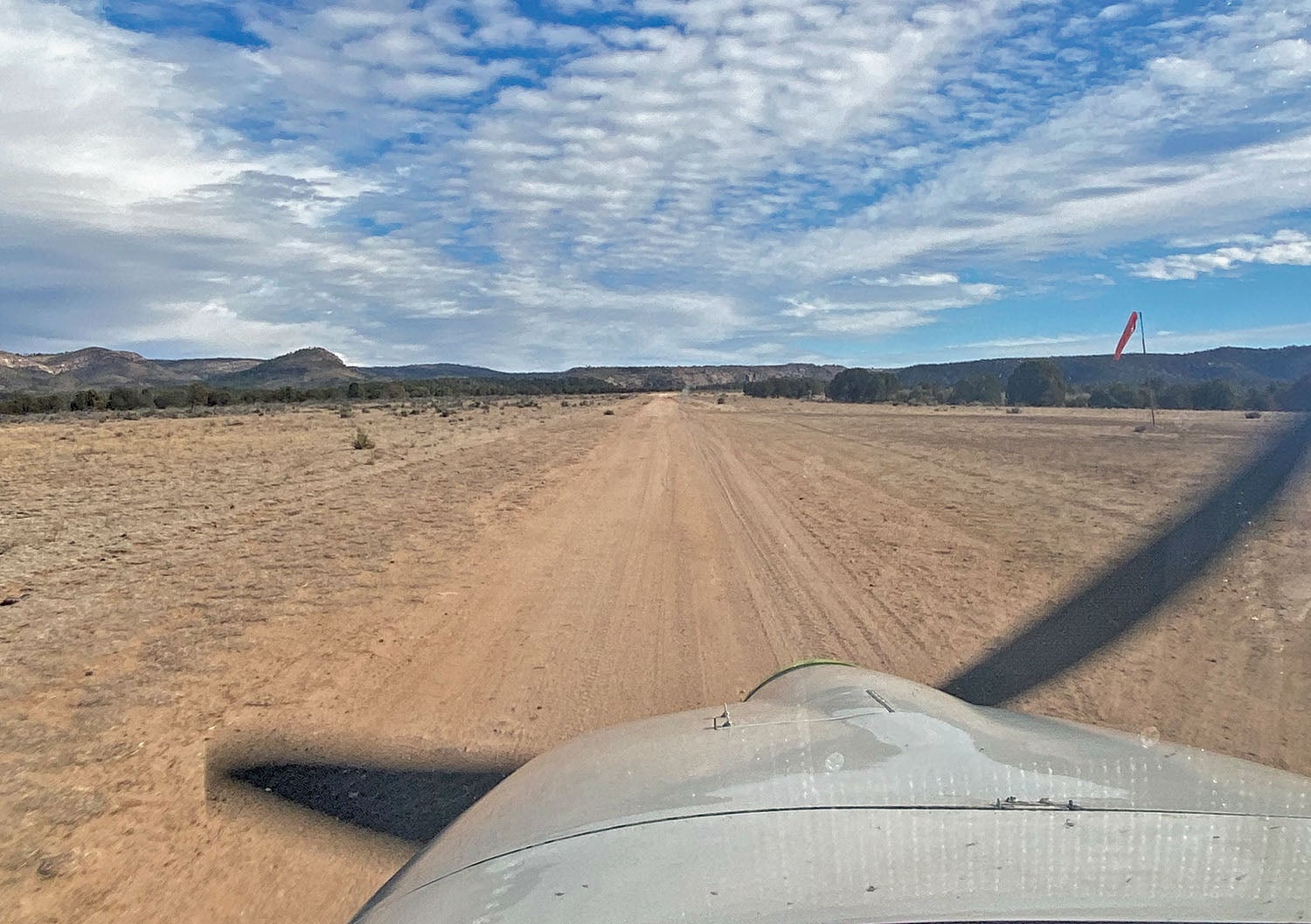

Arriving at a dirt-strip destination requires the same skills and practices as any paved runway—and then some. If in a group, maintain wide separation and have the most experienced pilot go first. Fly proper patterns if possible and always make proper radio calls. Most strips have some sort of wind indicator, but there are several other ways to determine conditions if not. Blowing dust or smoke, ripples on water, even cloud shadows on the ground can be helpful. Just be mindful of slope or other restrictions that dictate landing one way and departing the other almost regardless of wind. Fly the airplane first and scan out the window second. There is wisdom in flying over the runway first to check for conditions, wildlife, obstructions, and so on.
Dirt runways can be wide or narrow, long or short, but I’ve never seen one with centerline markings. That won’t bother most pilots if they don’t think about it, but it will bother some pilots if they do think about it. It’s like your first time with a stick instead of a yoke. If you think you might be bothered, go practice somewhere with an instructor first.
Touch down on speed at the appropriate target point and be ready to go around if that isn’t happening. The good news is that most aircraft on most dirt strips will stop shorter than on pavement. Experienced dirt pilots will often never have to touch the brakes as they skillfully manage their energy to take them to the parking area. Once securely on the ground and decelerating nicely, get the stick back as far as you can.
A common rookie mistake is to get too slow or stopped too early and then having to use a bunch of power to get to the parking area. The absolute worst thing (next to going off the end) is using a bunch of power as you move slowly or are stopped. That’s when you’ll hear the tick tick tick of money flying out of your wallet. (More on that later.) The absolute best way to park is well clear of the runway, pointed slightly downhill in the direction that you will be departing. A bonus is if you can coast the last few feet. If in doubt, once clear of the runway, just shut down and plan on manually towing the airplane to a parking spot. If the runway was muddy or slushy, don’t raise the flaps until they’ve been inspected for contamination. If you’re in a group and first to arrive, make sure you give a detailed report of conditions over the com frequency to those still coming in.
