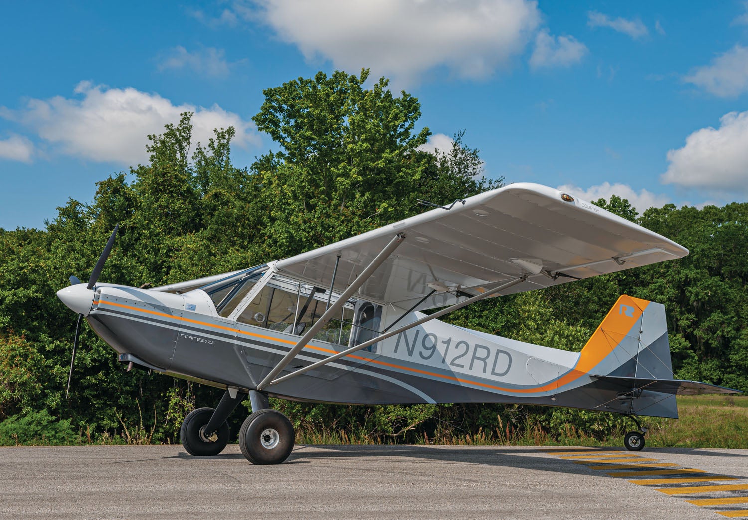

RANS S-7S LSA built by RANS. These planes are available assembled by the factory for those who do not wish to build. (Photo courtesy of RANS Designs)

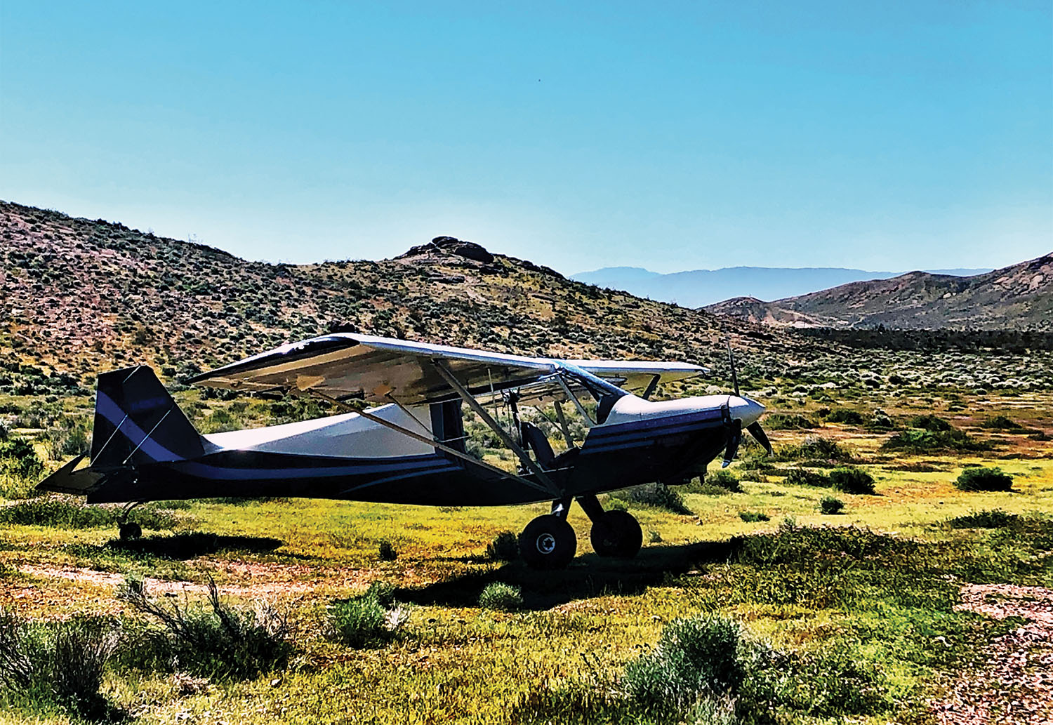

First, a bit of my background: I started flying 25 years ago. I hold a commercial rotorcraft and private fixed-wing license. Previously I owned a Rockwell 112 Alpine Commander. I purchased the RANS S-7S for a number of reasons. I was looking for an affordable off-airport plane with good performance. The cost of a lot of standard certificated planes was prohibitive. I wanted something with good STOL capability, so I looked at RANS, Kitfox, Just Highlander, etc. I decided on the RANS S-7S and it must have been fate. I was browsing the ads when I saw mine advertised. It is a 2015 and had less than 100 hours TTAF. I went down to Ramona, California, and gave it a spin. It was love at first sight. That was back in December 2019, and I’ve put right at 100 hours on it since I bought it. I love to explore. I live on the edge of the Mojave Desert and the Sierra Nevada Mountains. There are a lot of dirt strips and amazing sights. The RANS performs well, whether I’m in the desert heat or cruising by Mount Whitney.
Brian Moore uses his S-7S in mountainous and desert terrain.
