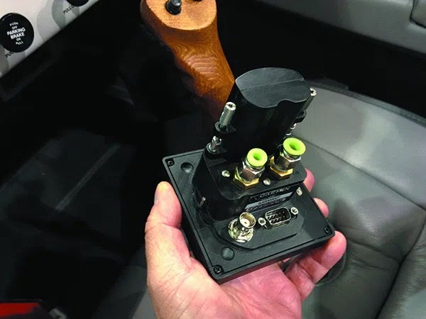

The battery is accessed from the rear chassis in the Aspen’s Evolution.
“Lithium-ion batteries, and Aspen’s backup battery in particular, should be kept charged. If they are discharged and allowed to sit for weeks at a time, the charge capacity is reduced permanently,” Aspen’s field service engineer, Michael Studley, told us. Aspen’s Evolution inflight battery logic allows the display to automatically switch to battery power if the power input drops below the normal alternator voltage level. On the ground, the display counts down and shuts off when power is removed.

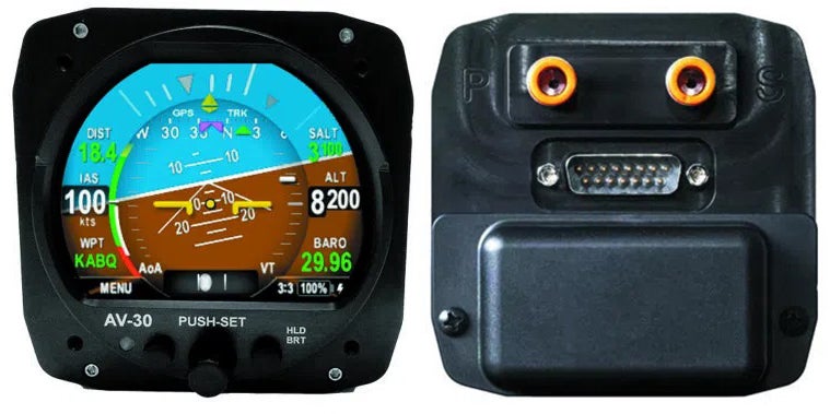

The battery in the uAvionix AV-30 instrument is tested yearly by setting the display to max brightness, pulling the unit’s circuit breaker and aborting the shutdown sequence and letting the unit run for two hours. If it doesn’t last two hours, it’s time for a new battery.
The uAvionix AV-30 has a built-in battery that’s accessed from the rear chassis.
