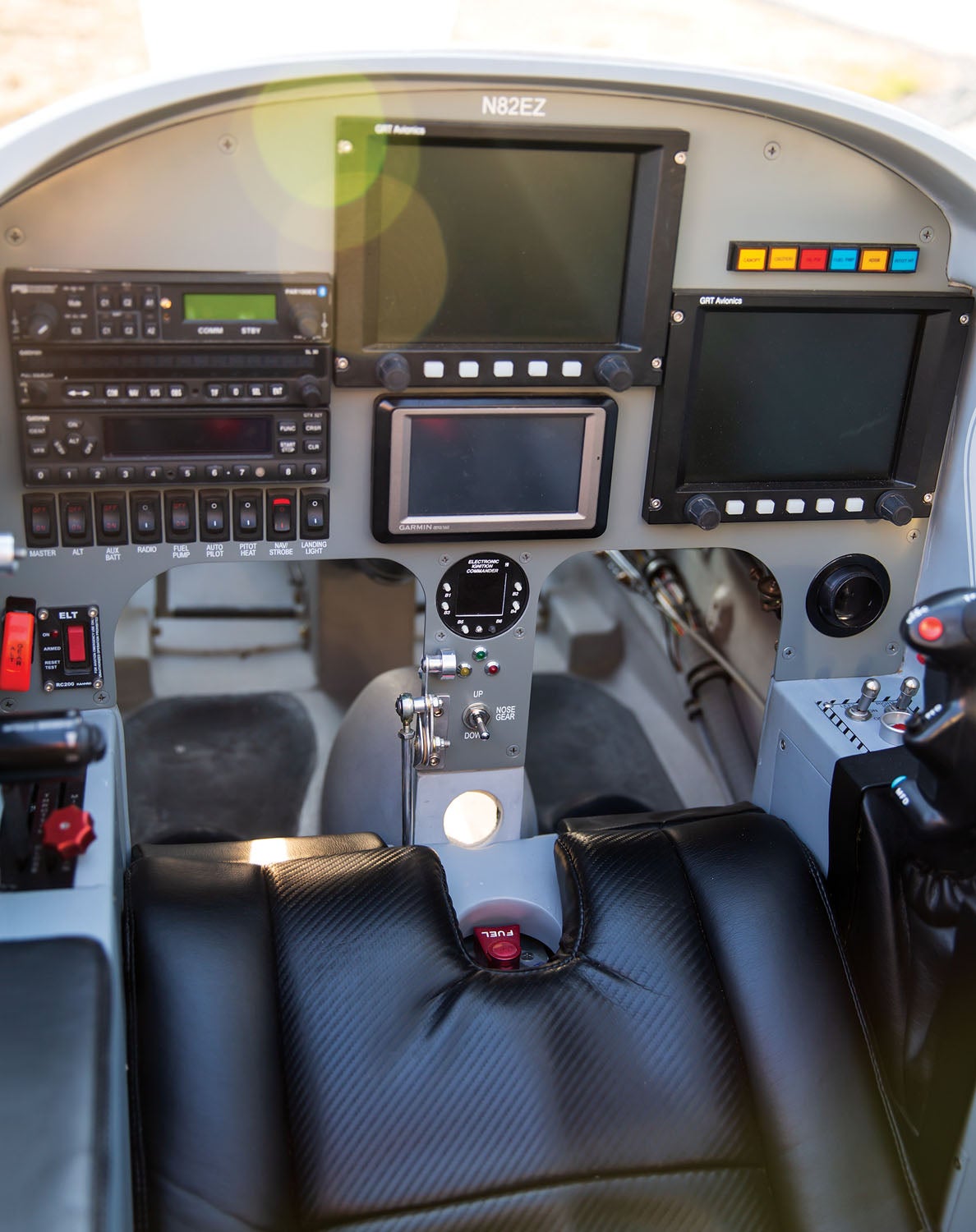

The cockpit was inspired by exotic racing cars and is very nicely appointed. The avionics suite includes a Grand Rapids Technology (GRT) electronic flight instrument system (EFIS) with primary flight display (PFD) and multifunction flight display (MFD) along with dual AHRS/magnetometers and triple-redundant GPS units. The ergonomic IFR panel is set up to utilize hands-on throttle and stick (HOTAS) functionality. There’s also a two-axis autopilot to allow for enjoyable cross-country flights. Fuel levels are easily readable in both the digital systems and the mechanical sight gauges. Nicely rounding out the cockpit is XM weather/radio, heated lumbar supports in the seats and side consoles that are molded to give more hip room.
One thing that is commonly overlooked by engineers and builders is what maintenance will look like down the road. Allen designed the interior panels and consoles as well as the inspection panels to be easily removed, simplifying future maintenance chores.

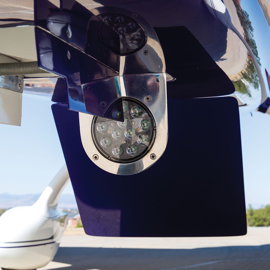

Unlike most Long-EZs, Excalibur has nose gear doors to reduce drag. Aft of the doors is a retractable LED landing light and the belly air brake.
