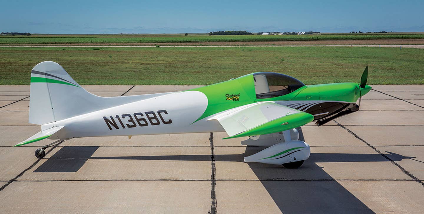

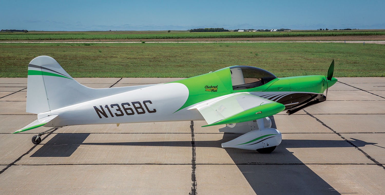

The Bearcoupe’s fuselage is slightly longer and wider than the Prospector, and the tail is different. “You can make the tail any shape you want,” Bounds said. He purposely replaced the original’s Cessna 180/185 angular outline with the sinuous profile of a WWII bomber, minus the tail gunner’s position.

While sketching a ream of unsatisfactory paint schemes, Bounds saw an ad for the Cessna TTX. “Its paint scheme was better than anything I could do, so I stole it.” Before applying the single-stage urethane, he did a lot of sanding. “As homebuilts go, the Bearcoupe is not a small airplane. You fill it, then block it all out, and do it all by hand with long, level sanding blocks to avoid ripples. It’s working on your upper body strength.”
