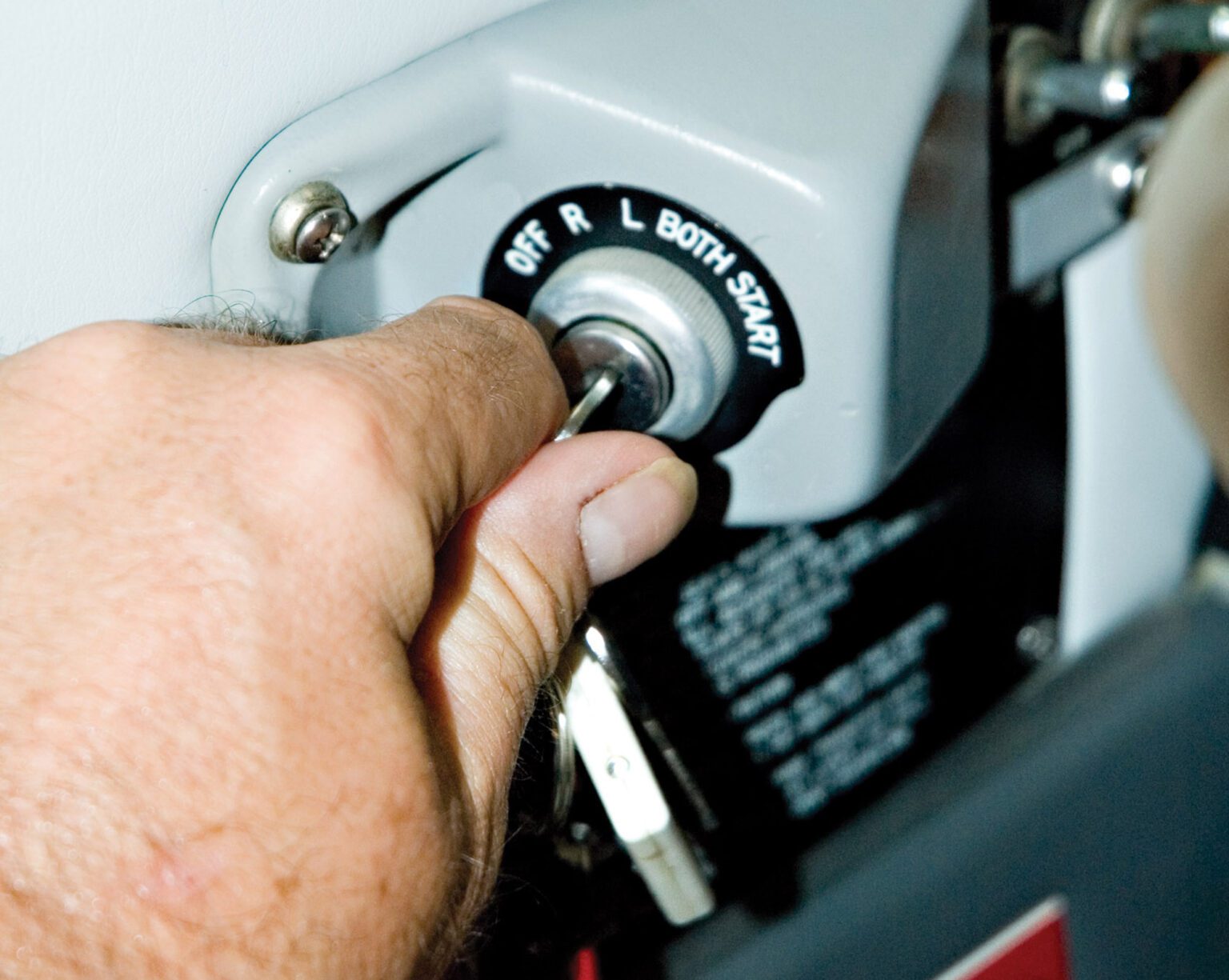

I had just dropped off my passenger and was about to take off on the last leg home. With bated breath, I ran up the rpm and switched mags. The first one I checked didn’t result in the expected rpm drop. Hmmm. When I switched to the problem child, the engine died. I switched back to both and tried again. Same result: The bad mag had finally given up.

I didn’t fly the airplane again until I had a mechanic hang two brand-new magnetos on the engine. At the first run-up after the work was complete, I was greeted with a tight pair of rpm drops, both well within spec.
