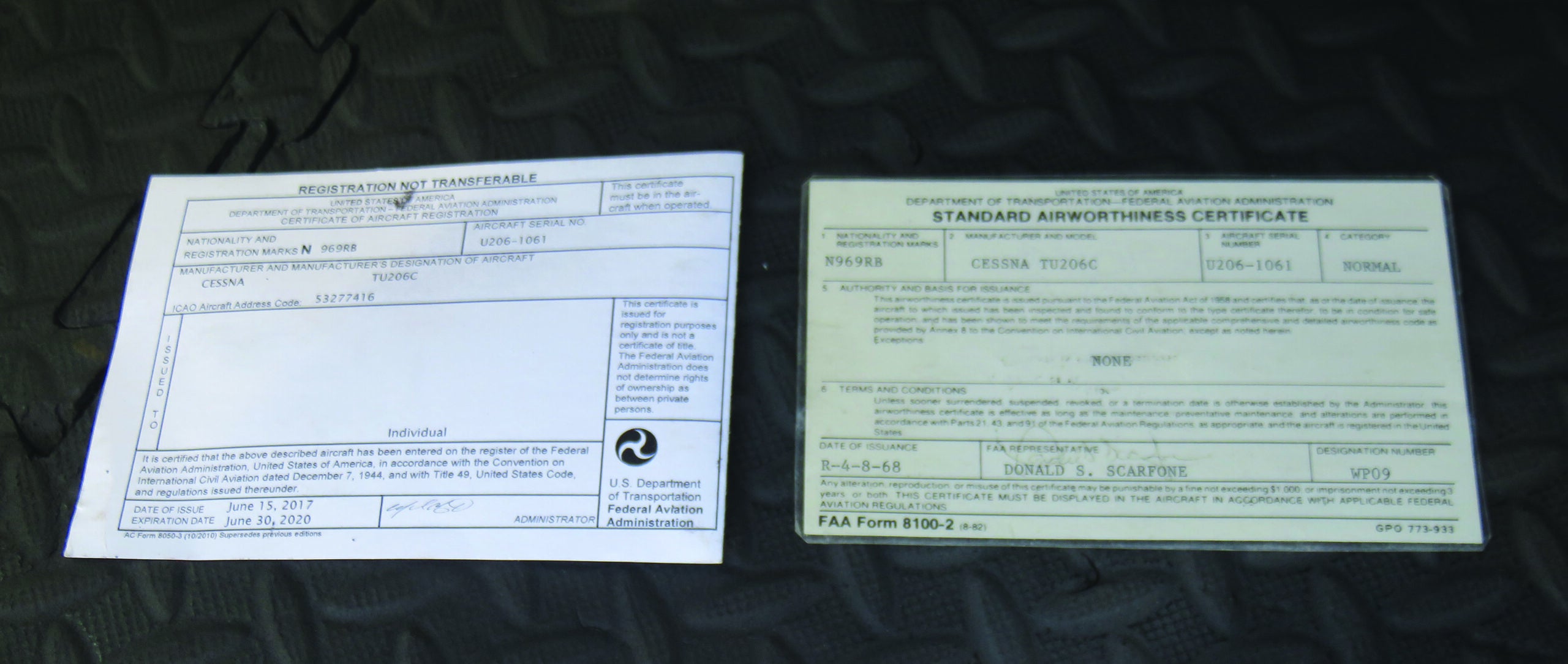

Originals of both the registration (left) and airworthiness certificates must be aboard the aircraft and in a visible location. A temporary registration also may be allowed.

The certificate of airworthiness must be displayed at the cabin or cockpit entrance so it is legible to passengers or crew and must be the original document, not a copy. The registration must also be current and prominently displayed. The FAA states that aircraft with an expired registration “would be without authority to operate,” and if you don’t know that walking in for your checkride, you’re not as ready as you could be. The airworthiness certificate and registration must be original documents, not copies.

A temporary registration valid for 90 days may be carried, but how would you determine that the registration is, in fact, current? The FAA’s records can be checked online: registry.faa.gov/aircraftinquiry.
