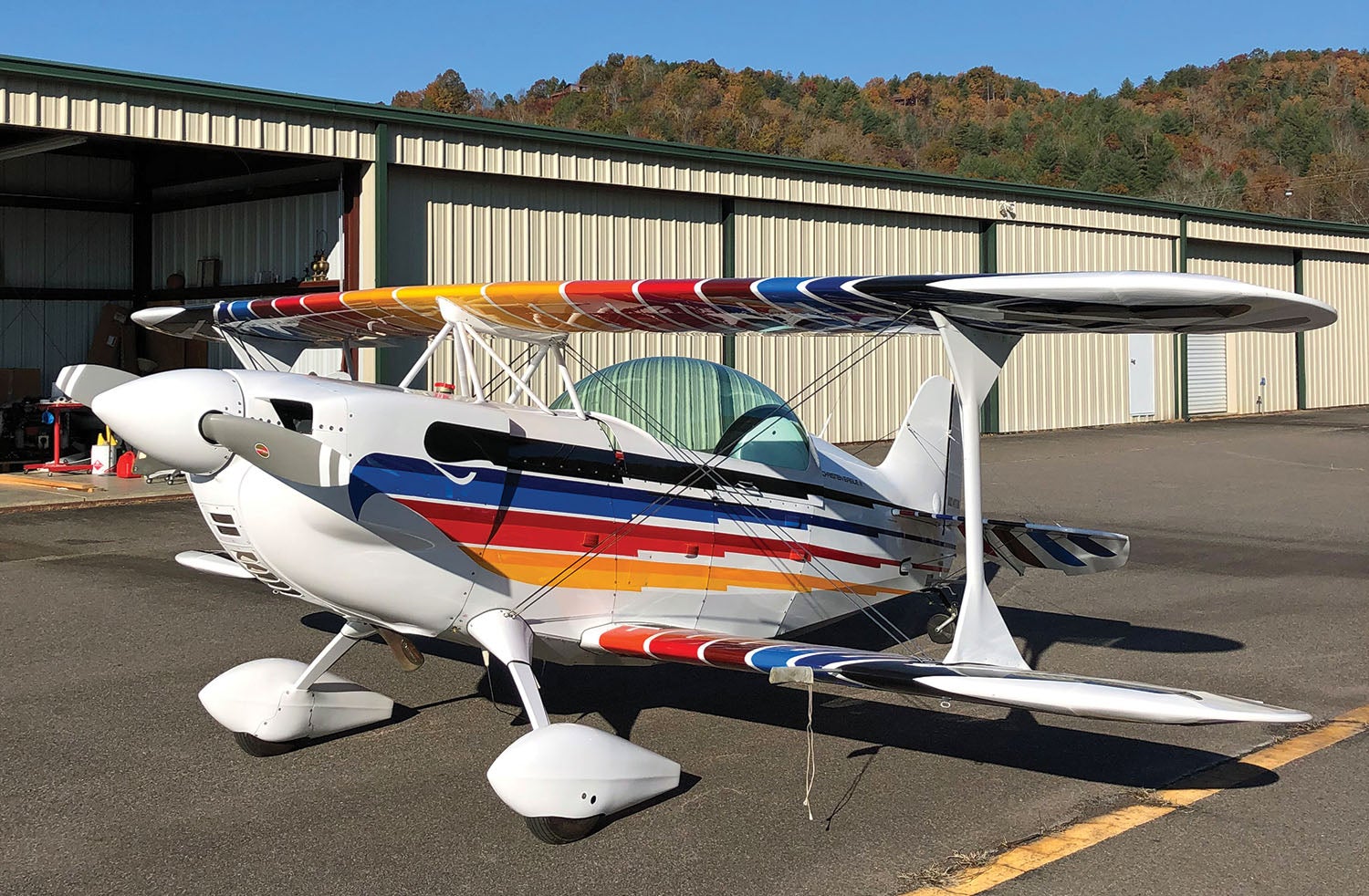

A 1994 Christen Eagle, famous for an iconic paint scheme that took as long to craft as the build itself. Or so the story goes.
Stan and Karen were camping at a large fly-in, their sunshade and lawn chairs next to a 1979 Christen Eagle. They had spent two years restoring the airplane they bought as a project. It was flying when they bought it and most of the work had been to recover it.
