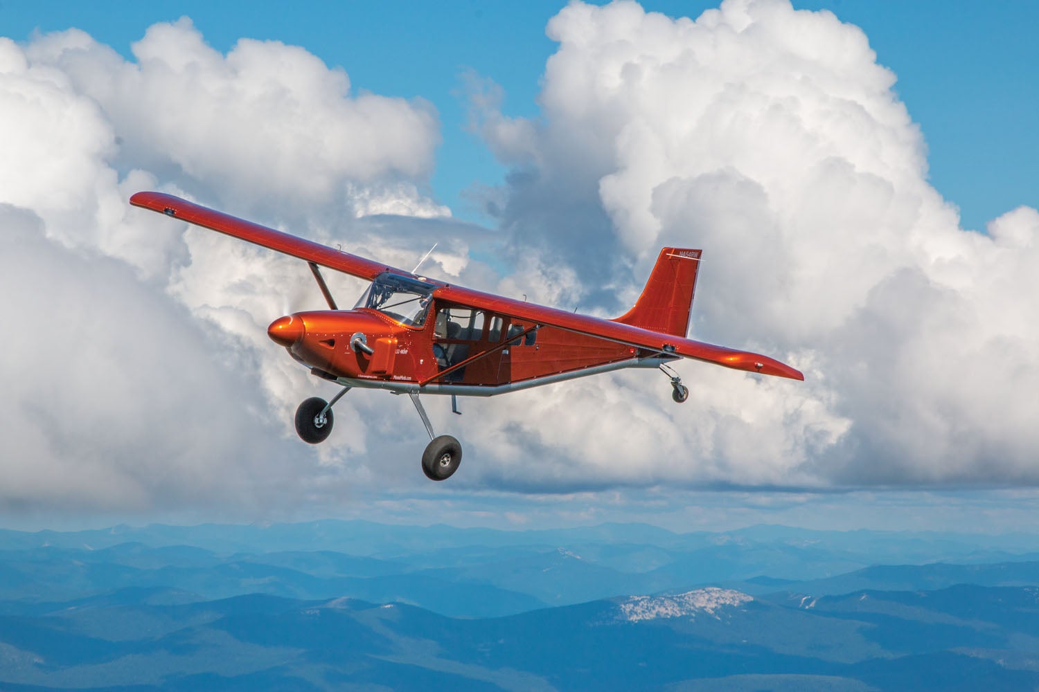

We lined up on the runway and Ray applied takeoff power. That crackle immediately spun up to a snarling roar and the Moose moved out smartly, tugged along by the three-blade Hartzell constant-speed propeller. Even with an 82-inch diameter, there remains 22 inches of clearance when the tail comes up for takeoff.
After a few hundred feet of roll, the big wing took over and we gained altitude quickly. We reached about 4000 feet, leveled off and looked around. The country in northeast Washington, just 50 miles or so south of the Canadian border, is lovely. There’s no end of mountains and large lakes—perfect Moose country. And in this Moose, it’s reachable without spending a ridiculous amount of time en route. Ray set the power at 4000 rpm and 18.5 inches of manifold pressure. We were indicating about 145 mph, or 124 knots. At higher power settings, Ray says the Bull Moose can see 155 knots true.

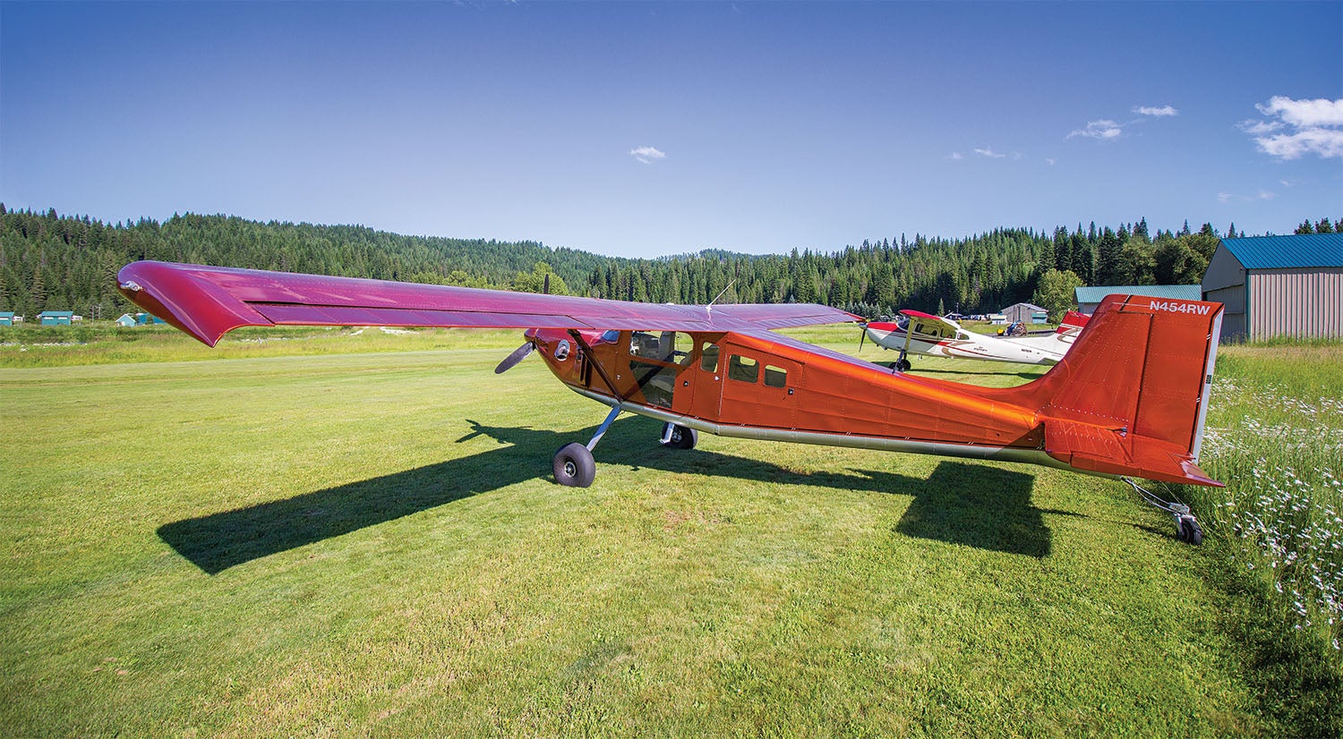

Bull Moose
The Bull Moose in its element—a grass strip in the mountains, ready to go.
