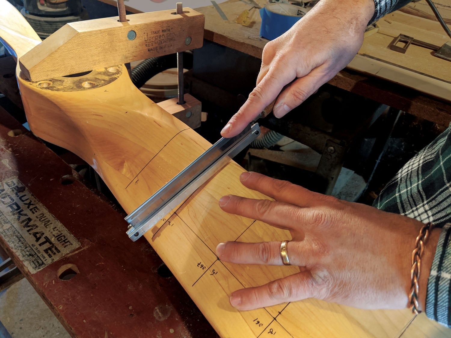

But how to do it accurately? Fourteen thousandths of an inch is a number more normally associated with precision metalworking than wood carving! One way to shape a wood surface is to make a series of saw cuts to the desired depth, then remove material between the cuts until the cuts disappear, not too different in principle from squaring lumber with a broadaxe between crosscuts when building a log cabin. Not wanting to take an axe to my propeller, however, a fine saw and an orbital finishing sander seemed a better choice.

I experimented first on a scrap board with a Zona razor saw inherited from my father. By clamping aluminum strips to the sides of the saw so that only the required distance protruded, it was possible to make cuts of the proper depth and no deeper. I tried a few different ways to set the saw guide precisely using shim stock or adjusting screws, but simply tapping it into position with a tiny hammer and checking it with a dial caliper worked best.
The guide is two aluminum strips clamped to the blade by 10-32 screws. Cutting grooves to establish the amount of material to be removed (right). The clamped-on guide makes it easy to go to the required depth and no deeper.
The cuts are full depth at the trailing edge, then the saw is carefully tipped forward to extend the cut forward until it fades out around two inches from the edge (I used 2/3 of the chord on the actual propeller). The orbital sander with 120-grit paper was then used to sand the face down until the cuts disappeared. This part is slow, as a finishing sander isn’t made for heavy material removal, but it makes it less likely to go too fast and remove too much material. The results on the scrap board were good enough that I was ready to try it on the real thing.
The first step was to draw chordwise lines at 3-inch increments, with a mark at the 1/3 chord point (i.e., 2/3 forward from the trailing edge) on each line, and lines connecting those points to give an approximate line to sand to. Next, the saw guide was set to the proper depth before making each cut.
Taking a deep breath and dismissing the “Am I going to wreck a perfectly good propeller?” thoughts, I made the first cut, then the rest of the cuts, readjusting the guide for each pair. Then came sanding. The birch propeller is a bit harder than the soft pine test board, so it was even slower, but this is a place where it’s important to take your time. If you remove too much, you can’t put it back! Gradually the cut lines disappeared as the surface approached the desired new shape.
