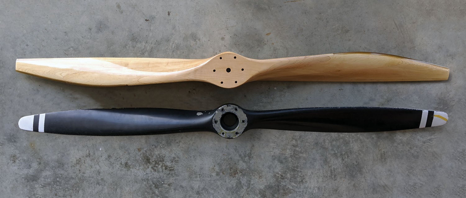

Metal vs. Wood
The new and old props. The blade shape is somewhat different.

When I bought my Hatz CB-1 biplane a year ago, it was equipped with an older Sensenich metal prop. Gus Milebach, the original builder of the plane, had tried a few different props, starting with a Hegy prop that he said “was a guess when I built the plane.” He then ran a Sensenich 74×54 wood prop for about 20 hours before switching to the aluminum prop from a Piper Colt “for more climb out of a short strip,” though he noted it flew faster with the wood prop.
The plane flew well with the aluminum prop, but I thought it could do better as the engine was well below its rated rpm and thus not developing full power in a full-throttle climb. Also, the old Sensenich 76AM series props were the subject of an airworthiness directive requiring inspection for scratches every 25 hours. There is some debate about whether ADs apply to Experimentals, but it wasn’t a big concern. Checking the propeller should be a part of every preflight inspection anyway, and the prop had been in service for over 50 years and hadn’t failed yet. Still, wood’s inherent damping means it should run smoother. A wood prop is also lighter and it just looks right on a biplane. Gus still had the wood prop and I considered buying it from him, but like him I valued climb performance more than speed. If speed is a priority, a biplane probably isn’t the best choice anyway!

The immediate impression was that the new prop was smoother running, as expected, and responded faster to throttle changes, also expected, as it weighed only 9 pounds versus 24 for the metal prop. The static rpm was about 40 rpm lower, but still within an acceptable range. I then took off and flew the same test series. Fifteen pounds less on the nose made for a noticeable trim change, but the plane was still well within the weight and balance limits. Takeoff and climb performance seemed a bit off, but cruise speed at the same rpm and top speed at full throttle both increased by about 5 knots. Full-throttle rpm, however, was running around 75–100 rpm less than the metal prop at the same airspeeds—an indicator that it was still a bit too much pitch.
After the first flight, the bolt torque on a new wood prop must be rechecked, which requires the tedious task of removing and redoing the safety wires. This I did, then went home and downloaded the data from the GPS and camera.
The data was disappointing. The GPS-recorded tracks were too uneven to draw any precise conclusions due to the rough air, so more testing would be needed. But it confirmed my initial impression that the wood prop gave less climb at all speeds than the metal prop. A couple of days later I tried again, though just with the new prop. Although the air was a bit smoother and the GPS data was better, it still wasn’t good enough for any firm conclusions. The best I could say was that the metal prop performed noticeably better.
