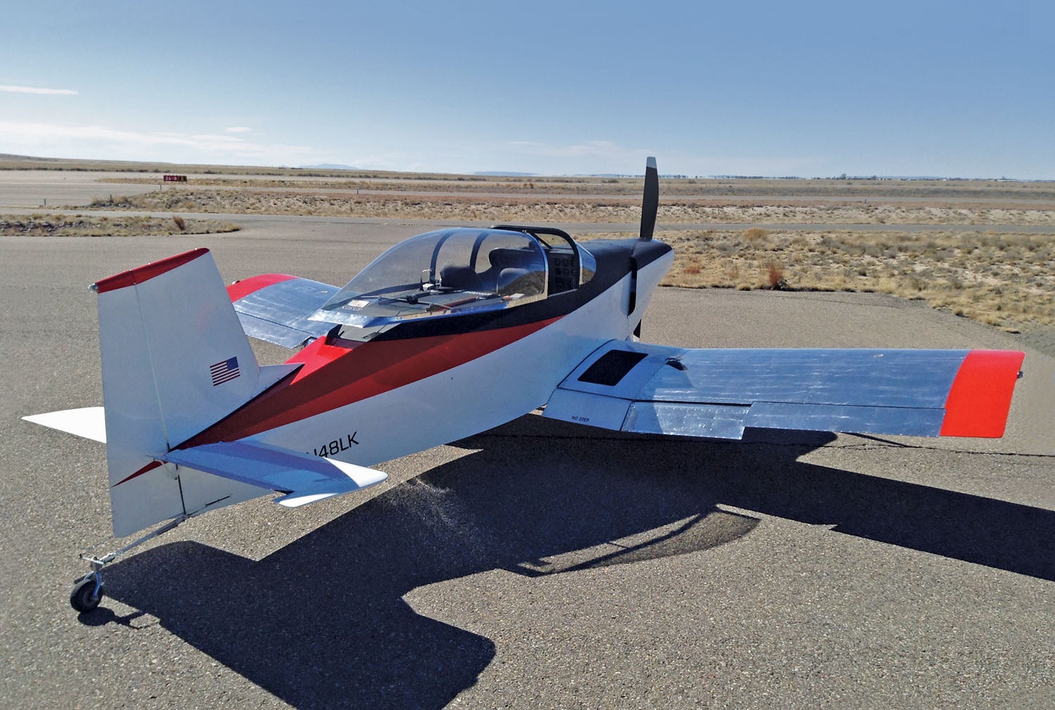

  • Les Krumel, a retired mechanical engineer, dedicated 22 years (1993-2015) to meticulously building his all-metal Thorp T-18 airplane, crafting almost every part himself.
  • Starting the project before he was a pilot, Krumel leveraged his strong mechanical skills, inherited from his machinist father, and self-taught aviation knowledge to construct the aircraft, even designing and electrifying various systems.
  • Upon its completion, the Thorp T-18 successfully completed its first flights, and Krumel has since logged over 220 hours flying it across several states, earning an outstanding workmanship award at EAA Oshkosh.
“Ever since I was a kid, I’ve always liked to make things, and I thought an airplane would be the ultimate project,” said Les Krumel of Moriarty, New Mexico, a mechanical engineer who recently retired as a civilian employee of the U.S. Air Force who worked on aerospace projects. That understatement defines his humble personality. Making almost every part, Krumel invested 22 years in his project, and he was not yet a pilot when he started in 1993.
Born and raised in Nebraska, Krumel’s father, Ermin, was a machinist and a tool and die maker. “He grew up on a farm, and there is very little a farmer cannot fix, and I attribute most of my shop skills to my dad,” he said. “He passed away about three years ago.” Krumel cannot pinpoint his aviation inspiration. Growing up, he didn’t know anyone who was into it, but still the allure of flying coexisted with his joy of building things.
