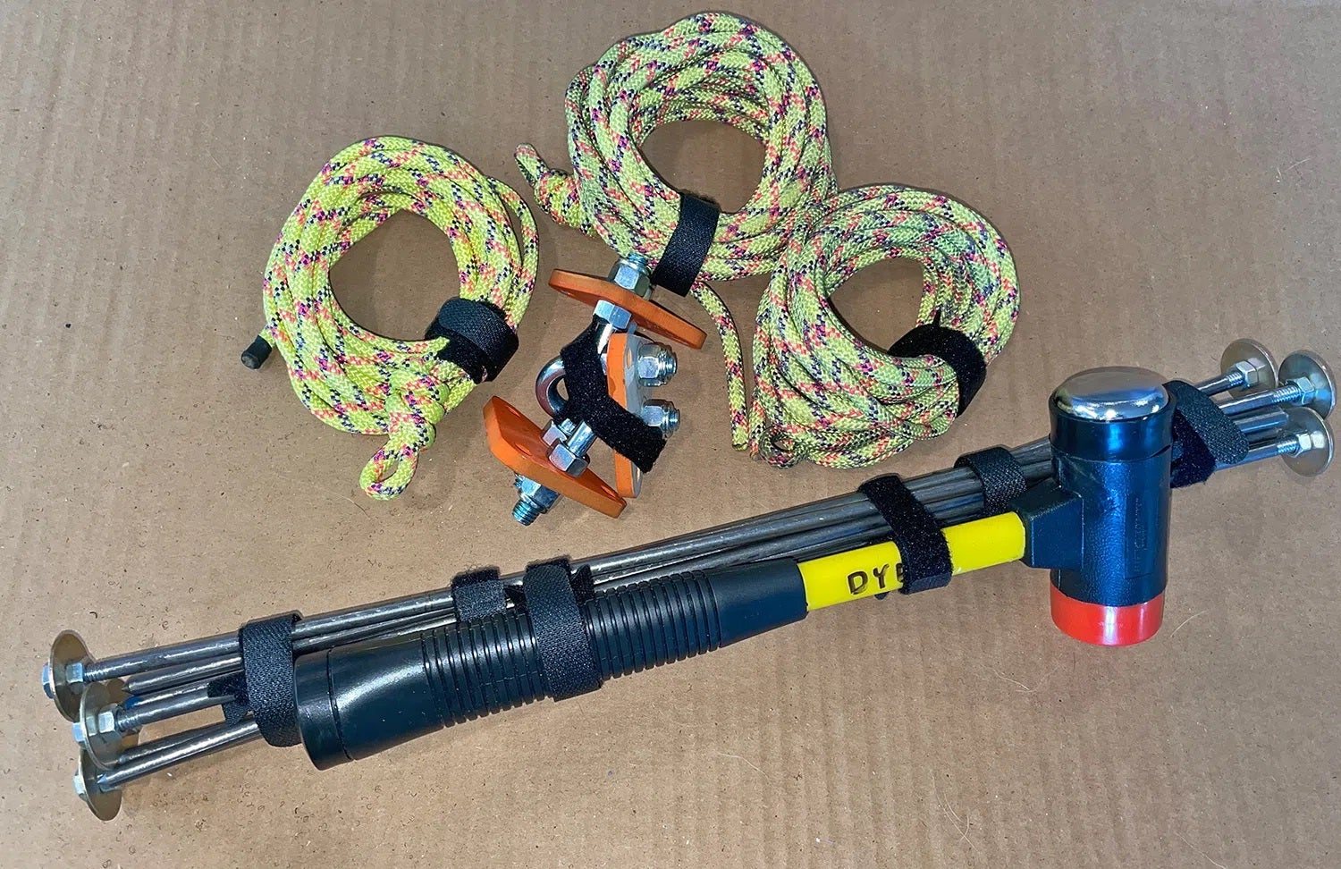

The tiedown kit.
The bill of materials is simple:
  • Base material – the plans call for 1/8” steel plate, but I used 1/4” aluminum because I had some.
  • Three 3/8” U-bolts and appropriate nuts
  • Four three-foot-long pieces of 1/4” steel rod – cut into eight 18” lengths, point on one end, thread the other 1/4-20
  • Handful of 1/4-20 nuts and fender washers
  • Tie down ropes (three of them cut to your desired length)
  • A Harbor Freight hammer and a pack of hook-and-loop straps to make it fancy!
The only tricky thing about the plans is that there are some measurements missing when you try and lay it out. If you start by drawing three lines from a central point at 120 degree spacing, then put the three corner holes in place, give yourself appropriate edge distance, and room for your U-bolts, you’ll be fine. One trick in drilling the corner holes for the stakes is to make them bell-shaped—larger underneath than on top. This allows for the stakes to angle as required. (You can do this if you drill with a Uni-Bit, and drill the bottom side bigger than the top.)
Velcro… uhh, I mean “hook-and-loop” straps tie the whole thing together in a nice package for transport!
